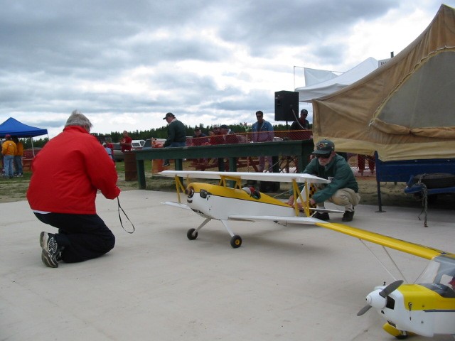

What is the wingspan of the BUSA Bipe....... sounds like a great combination.......Im trying to find a way to post a pic of my Ace with the 44cc twin installed here......stay tuned....

Lets try this..........
http://WWW.ca.geocities.com/tghmac20...e4kmff2003.JPG

Or try this..............
