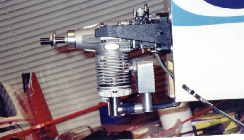

I've been flying a RCS 140 on my 25% Edge for over a year now. I think its a great little engine. Has a REAL weight(including ignition, muffler, switch harness, ignition battery, mount) of just under 3 lbs. The rpm figuers RCS posts are very realistic. I get 9000 rpm with a APC 16-8. Around 9500 with a 16-7. This engine likes to wind up and go, and I've had no issues with the high rpms causing any problems. I've had no mechanical issues with the engine at all, now around 10 gallons through it.
As far as glithes go, there is a week link at the plug wire's sheild connection to the ignition circuit board. You need a strain relief on the plug wire to the firewall, or vibration with break the ground connection at the circuit board. I found out just how good my JR fm ppm radio link is. If it would have been PCM, I could have lost the plane to failsafe.

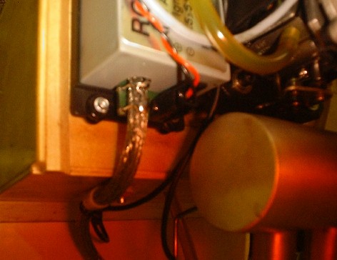

Tipover, please tell me, no wait can you draw me a picture of what i need to do to fix this ground problem if it has already broken on my 140. I have done everysingle thing to my engine and airplane to try and fix my low RPM glitch and this is the first time ive ever herd of this broken ground thing on the boot and or circut board, ive always suspected the sparkplug boot is causign the problem and have done everthing i can to stop anything from vibrating by useing a strong clamp on the boot, but since my ground must already be broken its still glitching even with a clamp, i supose the worst case sinario is if its broken at the circuit board part.

Take a look at the picture below. Look where the high voltage(plug wire) enters the ignition box. Its the two fine horse shoe loops of wire soldered around the HV shield that connect the shield to the circuit board ground. That is the ONLY point that the shield and black ground wire connects to the ignition unit. The wire loops in my photo are my heavy replacements, the originals were half that weight. Look real close, and wiggle the connection. Everything looked fine on mine, because the shield just hung there supporting the brooken loops of wire. Also take note of the cable clamp holding the plug wire to the bottom of engine box. That takes the load off the small wires soldered to the circuit board. I also soldered a second ground lead to my circuit board ground, and clamped it to my engine case. That acts as a backup ground in case the shield connection breaks again. Hope this helps.
