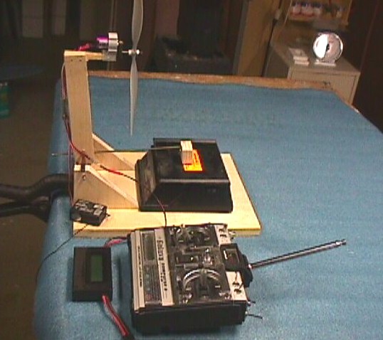

I made my own thrust stand for small electric motors - simple and easy to use and includes a Whattmeter so that direct power input to thrust can be easly compared as it goes.
Basically using a right angle arm of equal length - the force reads directly onto a gram scale -
very simple and accurate. and cheap to make.
For big stuff - as you know, there are lots of ways to do it -
The right angle arm has NO moving parts --the arm simply pivots
force applied to say 12"-- from pivot - will be exactly the same on the right angle arm of the same length.
If I was to make one for my 200 cc stuff-- I would use a A frame made from rectangular steel sections (cheap ) and add a right angle arm -of the same stuff -triangulated for torqueing resistance.
the scale could be whatever - heck -an old feed store scale would work just fine .

here is a pic of the lil electric one - a big one is easy for any welder to make

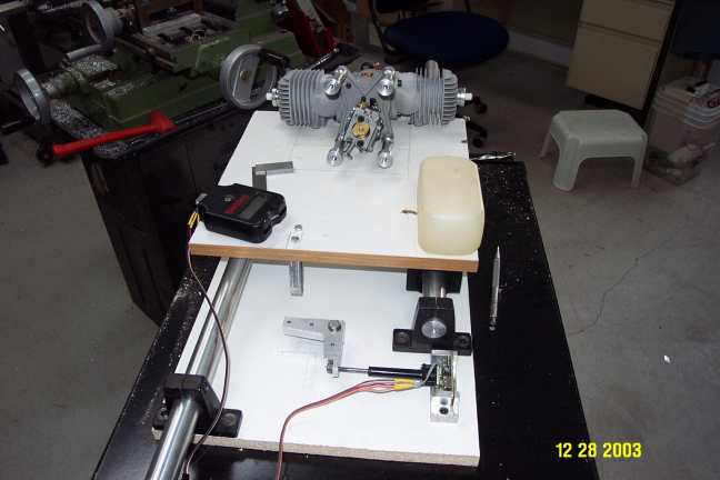

Old 12-28-2003 | 01:09 PM
Forgues Research's Avatar
My Feedback: (7)
Posts: 3,453
From: Glen Robertson, ON, CANADA
Default RE: Engine Thrust stand
ORIGINAL: Barry_G
I've often considered building one of these myself.
My idea was to use a couple of ball bearing drawer slides and build a simple rolling platform to bolt the engine mount on. Then use a digital fish scale. I'd build in a locking mechanism for starting and adjustments, then have a release allowing only limited movement (matching the linear distance spec. of the scale) to safely take the thrust measurements.
Your idea is good, but I would question the integrity of the drawer rollers because of the engine vibration.
I'll post pictures this afternoon of the mock up
Roger
Old 12-28-2003 | 01:51 PM
My Feedback: (7)
Posts: 3,453
Here are some pictures of the mock up only. Still a lot of work.
The two ptalform you see here are press wood and only mock up. The final unit will be of aluminum plates.
The linear bearing and rod are of 1" dia.

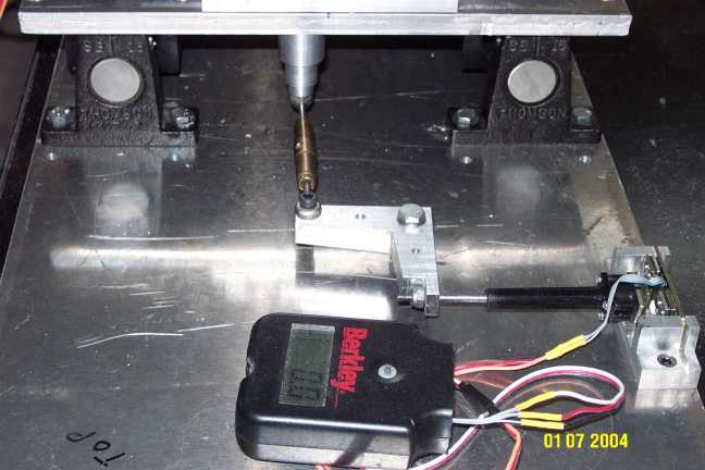

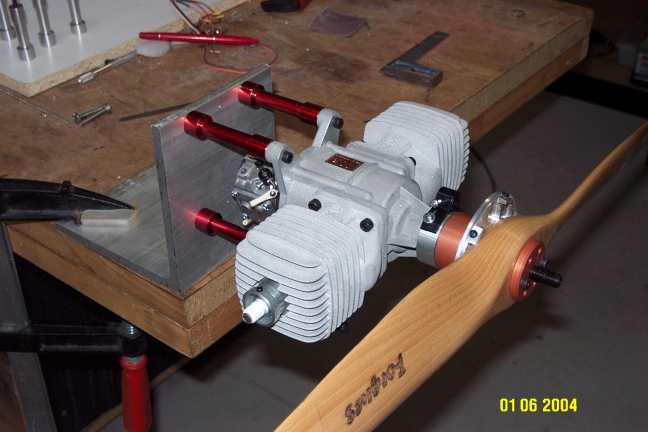

Old 01-06-2004 | 10:33 PM
My Feedback: (7)
Posts: 3,453
Here are some update photos
The last photo is showing a different mounting plate.
Roger

Old 01-07-2004 | 12:33 PM
My Feedback: (7)
Posts: 3,453
Here more photos, Now I need to finish up with the ignition battery/switch, fuel tank/filler, and throttle management.
