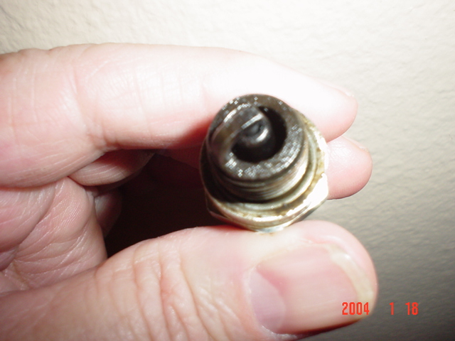

Ralph,
The plug was wet and black and both low and high needles were set around 1 1/4. What do you think....too rich.
Ken

Here are pics of the plug.
Ken

Too rich...the problem was the syncro spark module would get warm and malfunction...The problem was fixed by the manufacturer, who recalled all the bad ones and replaced them at no cost....

Now that you have that new plug in it, try to fire it up.....If it starts running like it did before, start leaning the needles out......
