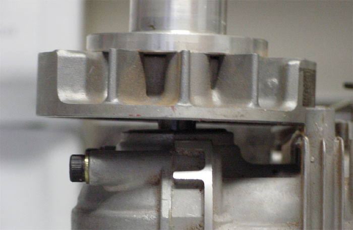

Last week, a fellow flyer crashed nose down and totaled his plane. He threw everything in the trash. I MEAN EVERYTHING!
I recovered the engine and the best I can tell it is a Zenoah G38. The only problem that I have found is that the shaft is bent. I would like to either replace or straighten the shaft. Is there any companies out there that can do this repair?
If not, then what is the method to remove the prop hub? All the screws have been removed and I cannot remove the hub from the flywheel.
Any and all responses are welcomed!

Default Bent Shaft!!!
Geistware, you are one lucky dude. You should have a good engine when it's fixed and it sure won't cost near what a new one does.
Everyone I fly with takes their junk home.
I made a spanner wrench to hook into one of the holes on the front of the flywheel. I then screw the hub off. It looks like you may have a later hub design than mine but I'm sure it works the same way. You will then need a gear puller to remove the flywheel from the shaft.
Ken
Just use a LONG bolt and screw it in to the hub, it will bottom against the crank. Keep turning and it will pop off the hub
Bennett says he will straighten them

Default Crank
Milton: Thanks for the referral...However, no one inquired...I charge $40.00, plus shipping,.Guaranteed straight..Is this too much ???

Default g38
I once had a G38 that I crashed and had Ralph at
rcignition.com straighten it and some other things done.
The engine was better than new when he sent it back and was quite reasonable also. This has been about three years ago so don't know what he charges now.

Bent Crankshaft
I just had Ralph straighten a G62 shaft for me. There is now no run out at full throttle. He did an outstanding job at a reasonable price.
