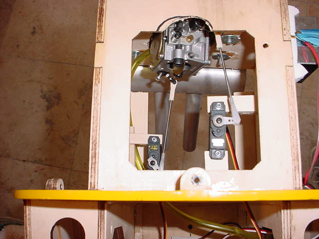

Hello all,
Do any of you have pictures of you throttle and choke hookups,
I'm trying to figure out how to do it.
The engine is going into a H9 1/3 Cap.
BTW this is my first gasser.

Hey guys I had a couple of thoughts. I noticed that some of the throttle installs are using all metal pushrods and servo's right near the engine. I always thought this was a sure way to induce RF noise into the system. Everything I read says to use non-metallic pushrods. [Hey Roger..now is a good time to plug your fiber-optic servo extensions...just kidding :-)] I have both my choke and throttle servo mounted in the fuse behind the wing tube and used nyrod type pushrods. I did not notice a detent on the choke it seem to work fine with a standard servo. I'm using a hitec 5945 on throttle which seems to provide rock solid throttle control. My concern with using a standard servo on throttle was the holding power since I am not using a return spring on my throttle arm. VinceL the choke can be operated manually with a rod but the servo for me is more convenient.

I was not referring to your pic when I made my comments, I have seen this type of install in other planes. Look at the attached pic. All I'm saying is that from what I've read this type of install is a not recommended. Roger can probably give a better explanation than I can but I was always under the impression that radio components(servo's,batteries..etc) were to be kept away from the ignition system. Notice in the pic that the engine is soft mounted, RC Showcase does not recommend soft mounting ZDZ engines. But the gentleman who installed this engine did so, I guess for him that was the right way to do it. It's your plane and you can do what you want.
Diablo maybe holding power was not the correct term. The butterfly on my ZDZ turns rather easily, what I wanted to avoid was using a servo that could not hold the throttle position or wandered. Correct me if I am wrong but I thought that when doing 3D maneuvers, such as torque rolls, throttle management and precise throttle control were important. I just didn't feel that I could get this with a standard torque servo and the throttle on my ZDZ. This is just my opinion and I may be wrong.

Your right in keeping the radio gear away from the engine/ignition setup. The only reason I get away with it is because I use the Fiber Optic extensions, sorry if this sounds like a plug again, but it does work.
I only use a digital servo on throttle and choke for its holding power. If you have a spring return on your throttle, then the digital is a very good idea because of the holding power .
