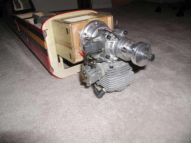

Here's a shot, sorry I forgot the name of the owner..

That's a great looking setup. But, I have to ask, is there any problem with having the throttle servo so close to the ignition? Everything I have read says to keep all radio stuff as far from the engine as possible.

don't know, it's not mine...I guess it works..[8D]

That servo's on the choke isn't it ?

Yes, but the wires are close to the unshielded spark plug wire.....

The round mount that attaches to the engine shown in the picture you posted, is that the integrated engine mount Wings mentioned that you provide. If so, is that included in the under 5lb weight? If not, and you provide it what does it weigh?

Yes, it's part of the weight..The ignition is inside it...I'm converting a few G62s this week, I can weigh one and get a good number..I'm working on making everything lighter to compete with the Fuji 64 electronic version
