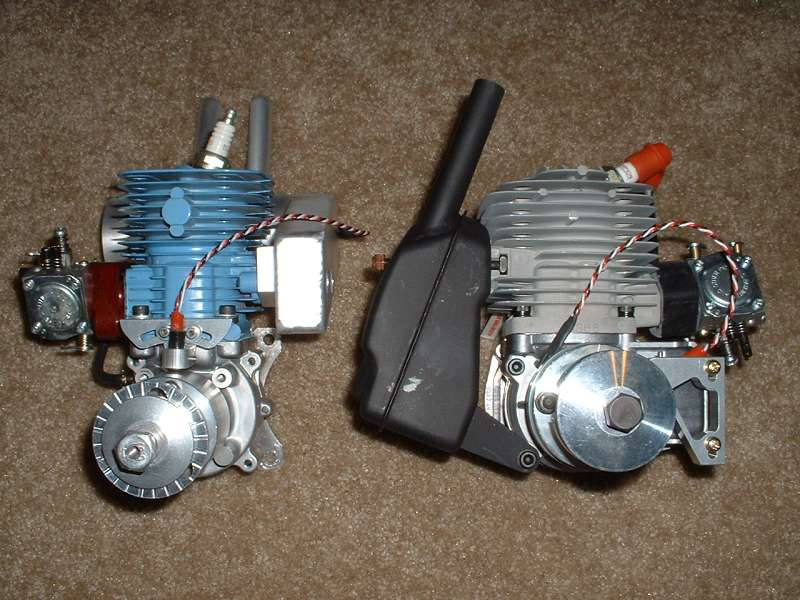

I too have both engines. Converted to CH Synchrospark ignition and equipped with a BCM wrap-around Pitts, my Fuji 64 turns a Zinger Pro 22x10 at about 7000rpm on the bench after maybe 1/2hr of running. I am sure it will get better as it breaks in some more.
I have had G-62s before, but the latest one I just got in has the large volume muffler. It has two stingers pointing straight down (engine inverted) very near the cyl head. It also has a third support point in addition to the two through bolts. This one is in the process of getting converted to CH Synchrospark as well. I just have to time the hall sensor and it'll be ready to fire up.

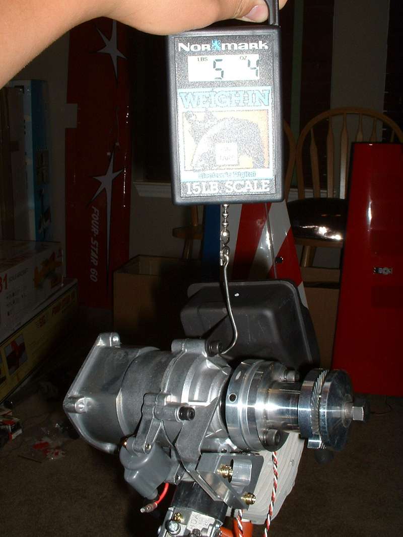

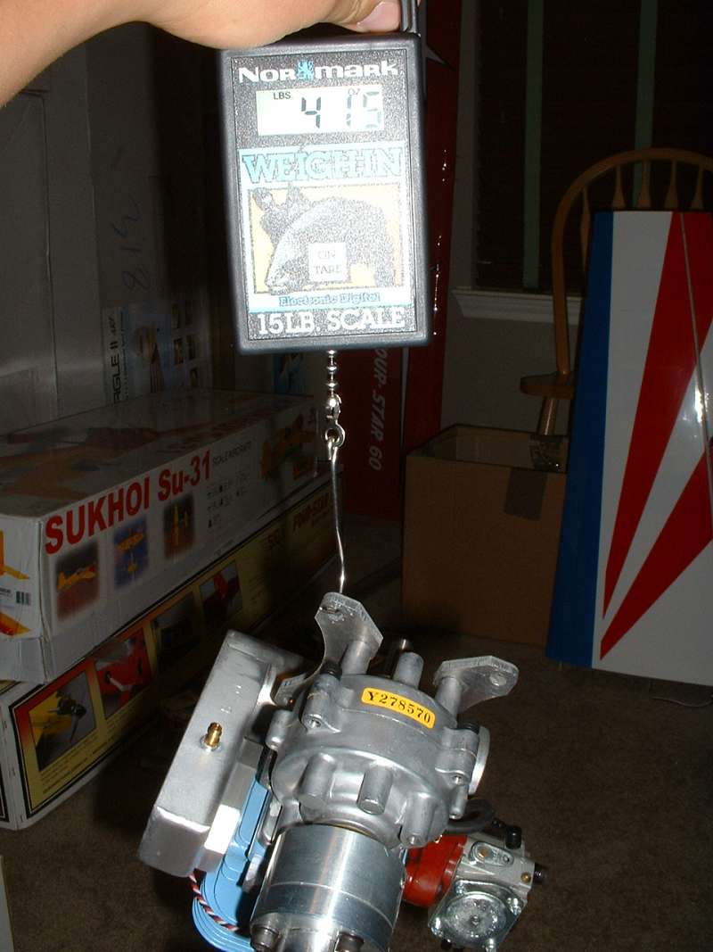

One immediate observation is that, AFTER EIS conversion, the Fuji is considerably lighter than the G-62. With the BCM Wrap-around Pitts, which is fairly heavy, the Fuji weighs right around 5lbs without the ignition module. The G-62, converted to CH ign and with the stock muffler weighs 5lbs 10 Oz. The G-62 does have the external ign coil, so the difference is maybe 2 Oz less. Still, that's 1/2lbs difference.
I will reserve my judgement after I put a Pitts muffler on the G-62 and run it on the bench. Still, the legendary reliability of the G-62 is hard to beat. I know these days the talk is all about the sexy and svelte DAs and ZDZs, but I just have a soft spot for these humble industrial engines.

WHAT?! No blue paint??!! That does it for me.
Okay, me bad for remembering wrong. They differ only by about 6 Oz. More than likely not enough difference to worry about. The 5lbs 10 Oz. engine I recalled was acutally a Walker 4.2 I am working on for a friend.
The latest G-62 still has the steel mounting plate. I got a B&B cup mount instead. Ralph, did you have to cut off the rear shaft in order to fit the EI module? I don't mind loosing a couple of Oz. there, but like you said elsewhere, the front and rear shafts are exactly the same. In case of crash bend front shaft, just swap ends.
Ralph, I am curious to find out what your G-62 RPM readings will be with the new style muffler. I don't have any reading with the old style muffler to compare against.
I agree about the small mounting screws on the Fuji. Besides, I don't know why they don't just make the aluminum mount one piece. It will be stronger and can't possibly weigh that much more. I like Fuji engines, especially the 86T, which is surprisingly lightweight after EI conversion. But all Zenoahs except G-38 have external coil, which lowers the conversion kit cost and also makes installing the ignition module much easier.
