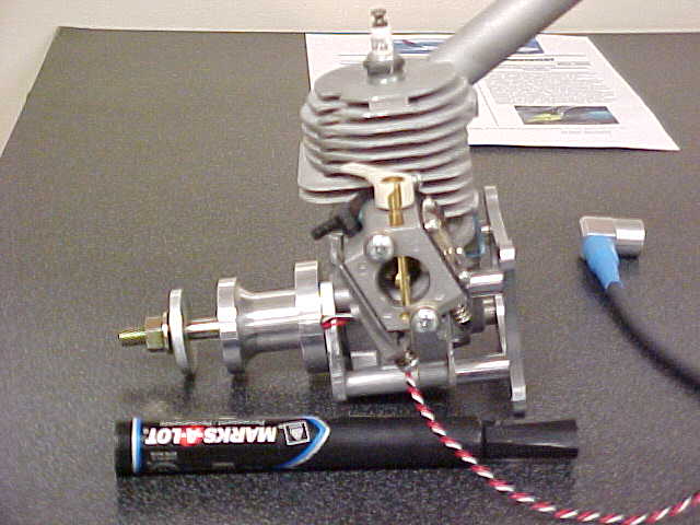

How does the Canaday 29cc engine compare to the electronic ignition converted G-26 based on the information below? I have included as much info as I could find on RCU. Refer to page 10, Post #284 in Great Planes 1/4 scale Gene Soucy Extra 300S for a pic of this engine.
Engine Specifications:
Weight: 44 oz. (w/ignition, less battery, switch, & muffler)
Spark Plug: CM-6 NGK Mini
Ignition: C&H Syncro Ign. w/ Shielded CNC Cap (auto retard for better idle & starting)
Carburetor: Walbro
Tuned Air Horn: Standard
Carb Insulator: Turns shaft for Straight pull
Prop Bolt: 8 mm (no necked down stud to break)
Custom CNC Lite Motor Mount & Stand offs
Muffler: Fits G-23/G-26
Introductory Price $399.95
*Cylinder may be machined round for $15 extra
Performance with stock g23/g26 muffler:
15 x 8 APC 10,500 rpm. 17 x 6 APC 9,800. 16 x 8 APC 9,500. 16 x 10 APC 8,500. 17 x 8 APC 8,300. 18 x 6W APC 8,300. 18 x 6 Mejzlik 9,100. 18 x 6 Menz 9,000. With tuned canister gains of 400-600 rpms are seen.
Static Break-In:
Make sure that Jack’s 29 cc is mounted on at least 6mm/1/4” aircraft grade plywood, and is firmly fixed with 4 bolts.
We recommend a 1200mh NiCad or NiMH battery. Use a heavy duty on/off switch.
For the first ½ gallon of running we recommend a 16 x 8 prop.
For the first 2 gallons of running we recommend a 32:1 mixed ratio consisting of 3 oz./gal. Lawn Boy Ashless Oil + 1oz./gal. Racing Castor.
After 2 gallons we recommend a synthetic/castor mix @ 40:1 mixed ratio. Bel Ray, Mobil 1, or Honda Racing, @ 2 oz./gal. + 1 oz./gal. Racing Castor.
Prop Recommendations for Flying:
120 Size Aerobats- 18 x 6 Mejzlik or Menz
120 Size Warbirds- 16 x 8, 17 x 6, or 17 x 8 APC
We have experienced the best performance with these props and do not recommend other brands at this time.
Lathrop Small Engine Service
P. O. Box 125 125 Maple
Lathrop, MO 64465
816-528-3937 [email protected]
"The prototype was based on a Zenoah but number two is based on a photocopy Chinese engine that is very similar to the G-26. The machine work is a bit better. Call Jack Canaday with any questions at 816-528-3937."

Ah, progress...Looks very close...I think mine would be lighter if I chopped of the back of the case and put the ignition in a separate box...The Canaday is stronger using a stock G23/26 muffler..
Guess I'll have to send away for a Sikk 29 and modify it for a comparison..

Hmmm...
It's the same base weight as my Brison 2.4 (39cc) which is $20 cheaper an more powerful...

APC 17x12 @ 7750 rpm

Warren, could you explain that a little please. What is the same "base" weight as your and Brison 24 and $20 more expensive.

The Canaday 29cc motor we're talking about is the same weight bare, but $20 more than a Brison 2.4 which is 39cc.
