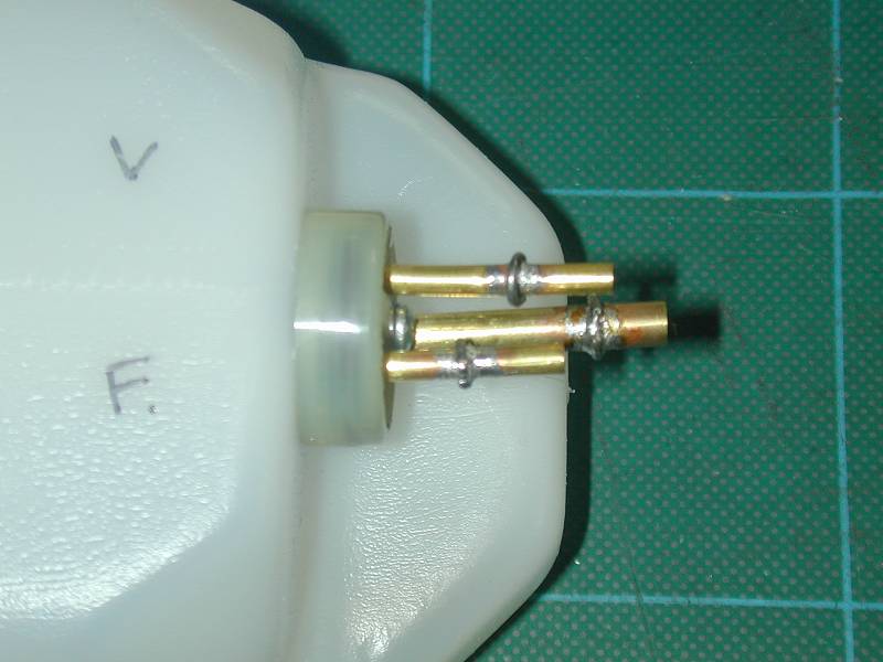

Not one of you guys advised him not to use a Sullivan fuel stopper, they do break down and clog up everything, only use the brown Dubro stopper with the raised 0 on its outside face, I use paper clip wire to form barbs on the brass tubing, and a three line system to ensure my fuel is filtered twice.
Mike
