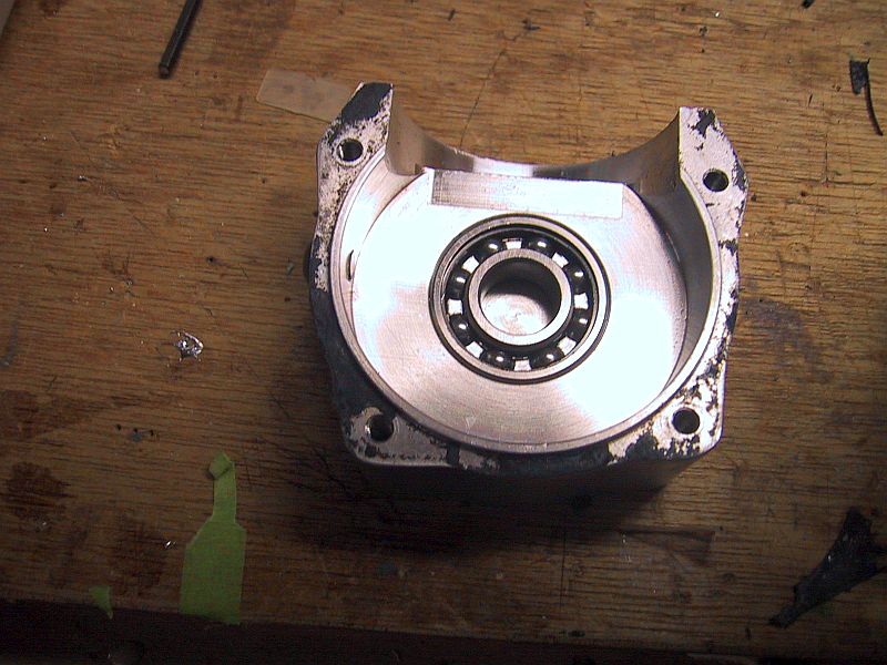

Terry the two blade prop hub and single bolt adapter that I got from you a few weeks ago worked great. The engine had never been run before until I started it. After a little break in it was turning an NX 22x10 prop at 7500. After an hour of running at various speeds on the test stand I removed it and it sat around for a few days. I picked it up, removed the plug and turned the crank. The bearings felt really rough. Before I got the engine it sat in an un air conditioned garage for 10 to 15 years. I guess condensation did a job on the bearings. When I took it apart I noticed that both bearings had no identifying numbers on them. A local bearing supply matched them and the seal. After reassembling, it was smooth as glass and turned the same RPM.
Do you think it was made by Walker Machine or A&M? Here are some photos to help you decide.

You have a midrun A&M. Sorry[]
A Walker would have a bronze/steel con rod
Check your end play on the crank, some of the A&Ms went out with the wrong bearing crush. The case was not bored deep enough and when you tighten the case together it would squeeze the bearings and put a side load on them and distort the crankshaft. Made for a short lifespan.

You are not as sorry as I am. I can't feel any end play. The inner race is pretty tight on the shaft and this may be preventing my feeling end play. I have 3 other orange case Sachs Dolmar engines. I can't feel end play on those either. The 2 G-62s I have I can feel a little end play. The engine was given to me and I only invested about $90 into it so I think I'll just run it and see what happens. At this point it runs super.
