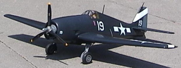

popierre and I have had several ideas regarding Precision Eagle 4.2 engines from Bryon. I was able to make significant improvement by:
- using higher octane fuel
- using synthetic oil at 100:1 mix ratio
- switching to ProZinger series props
- finding a build error in the carb
However, the last, big change was provided by popierre - he suggested dumping the PurrPower muffler and replacing it with a Pitts style from JA Engineering.
What a difference - gained 300-400 RPM, and the engine operating temp has dropped dramatically. After running with the PurrPower, I could fry an egg on the crankcase. Now, I can touch the JA Pitts muffler immediately after running, without pain, and the crankcase and head temps can be described as 'warm to the touch.'
I'm now running 6.2K -6.3K with the ProZinger 24x10. This is spec in the Bryon materials for a Zinger 24x10 - I don't know how they could have gotten there running natural oil, low octane and a PurrPower muffler.
This plane will fly, this year, finally.
Thank you, to all those that contributed, especially, popierre.
The PurrPower muffler does create a nice sound, but its better used as just an engine mount - cut the header off to make room for a JA Engineering Pitts muffler, you'll be glad you did.

It flies!
Was a bit of a scorcher Sunday at 91 degrees F. and high humidty, little wind. But with some help from veteran warbird pilots from the Plymouth-Canton Flying Pilgrims, my Hellcat finally left the ground - twice, and returned to the ground safely - twice!
Thanks for all those that offered guidance on this subject - I used much of it. Thanks to your help, I now own an RC warbird aircraft - not just a model! Models sit on shelves, aircraft fly.
