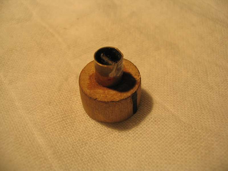

For adjusting these, might I recommend the following little tool. [link=http://bennettbuilt.com/page10.htm][LINK][/link]
Took me about an hour to knock off a couple from dowel and brass tubing in my shop.
