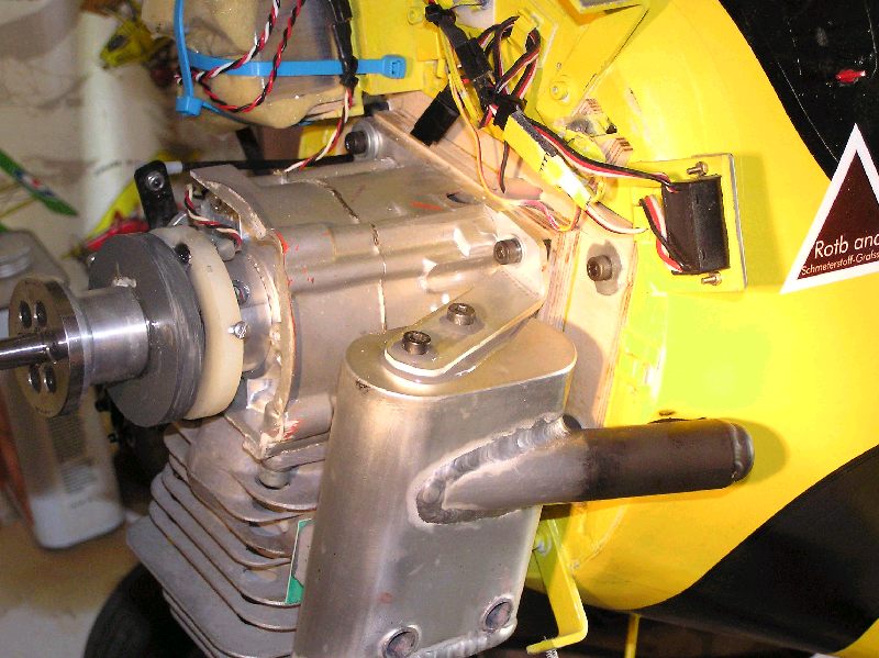

Geistware, do you think a brace like I am using on my modified Bisson muffler would help the problem? It's attached with socket head screws and JB Weld.

Yes, I do think the brace will save your muffler but I don't expect the JB weld to last very long in that application JB weld debond's with heat. That is how I get it off of parts. You may want to weld the bracket to the muffler and make sure it is bolted to the engine and not the firewall. You installation loosk good to me.

Geistware, the plane has about 20 flights on it with the muffler in this configuration with no sign of deterioration of the JB Weld. I didn't use the JB Weld as the primary attachment. I think that the reason that it is holding up is because there is a lot of airflow around the top of the muffler. It is not like being in the direct exhaust. The reason that I installed the brace is that the muffler mounting screws kept loosening up. As far as being attached to the engine, for all practical purposes it is since the screw goes through the bracket, engine mounting plate, and then into the firewall. No movement in the bracket. The bracket idea came from using the bracket on my Bisson Pitts style muffler on my ZDZ80RV.
You are right, welding the bracket would have been the best choice. However, I thought I would try it this way before taking it back to the welding shop and spending another $20 bucks.

Ken that sounds good and if it works go with it.
For your bolts, try the red RTV for high temps.
It works great and that is what I use.

I agree the Bisson muffler is will allow your engine to turn faster with the tips cut off or reamed out. It will be louder. If you don't beleive me then take an "in the air" measurement before and after.
ALSO, I found that JB Weld is good to 600 degrees F. I have new respect for my heat gun
