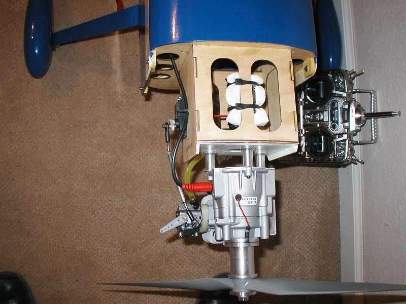

I am just about to send my G23 to Ralph to get his electronic ignition added and lightening mods done to it.
I would certaintly appreciate if someone could post a couple pictures of their RC Ingitions modified G23 engine,as I have never seen what the finished product looks like. Thanks.

Only change is the spark coil is mounted behind the cylinder where the source coil was and 2 small rings around the hub near the crankcase.for the sensor and magnet...The carb has a new rotator block, 3/8 thick...The throttle servo connects directly to the carb, no bell crank...There is a small RCA jack in the case under the carb to connect the ignition circuit to the battery.....

I have a G26 that has been modified by Ralph if that helps any.

Ralph, what is done that allows for the weight reduction of almost a one lb.
Old 04-01-2005 | 10:10 AM
Antique's Avatar
Posts: 9,825
From: Somewhere, DC
Default RE: RC gnitions modified G23
Removal of about 1 inch of the rear crank, the mag rotor, the nut, and the source coil...
