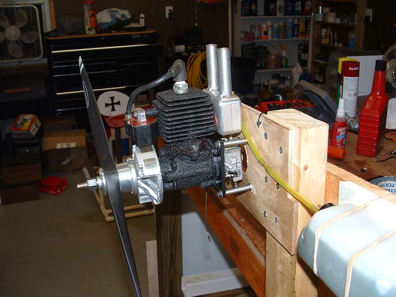

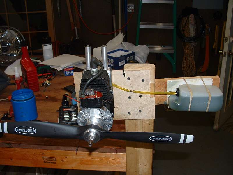

I have a Ryobi 31cc single ring that I cannot get to tune out. It will idle all day and run at around half with little problem. When I advance above half throttle it dies. I thought it was leaning out, and as I richen the high speed it gets better but does not tune out before the needle loosens. I started with both needles at 1.5 turns out. The low speed is fine around 2 turns. I had it running well for about a ΒΌ of a tank and I stopped to fuel and problem was right back. I have tried 2 plugs, no help. This is with a Walbro carb, I also have a Zama that it seems to do worse with. Operating temps are around 300-325. I am new to tuning and am lost. My fuel tank is a basic nitro setup with the pressure line venting to the atmosphere, could this be the problem, is this right??

Thanks for your quick response and good ideas. The fuel does flow unrestricted when disconnected and even pours threw the carb depending on where the tank is mounted. I did check the filter screen in the walbro and found it clean. At the same time I checked the diaphragm and it looked good. As far as air leaks, I don’t think this is the problem, I have remounted the carb many times and I have a good gasket. I think you are on the right track with fuel delivery, I am not too clear on weather or not my tank is set up properly. I am including some pics, do you see anything wrong.

Basic nittro? Are you running gasoline or glow fuel in it? The vent should be open to the atmosphere, and the klunk should be no closer than 3/8" to the back wall of the tank.
