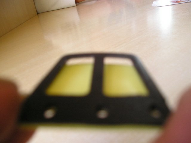

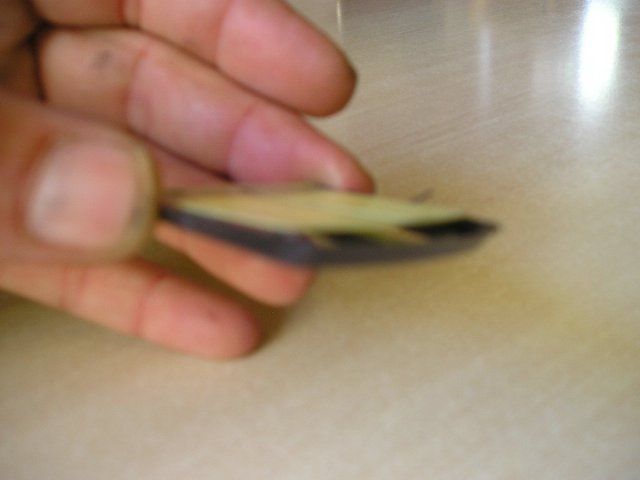

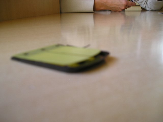

Yesterday I tried to fire her up with the tank left full. This didn't solve the problem so I opened the engine to check the reed valve. The valve isn't closed at all so maybe the problem has to be in there. I tried to bent the valves so they are fully closed. I don't know if they will stay closed. Crusty, if you think this will cause my problems I'll buy a new valve.

Those reeds are knackered...technical term

replace reed valves. mine did the same thing i also changed to a three line tank and this seemed to help.imo

take a monokote iron and remove the peddles and iron them down flat and this will fix them right up.i do it all the time and it works great
