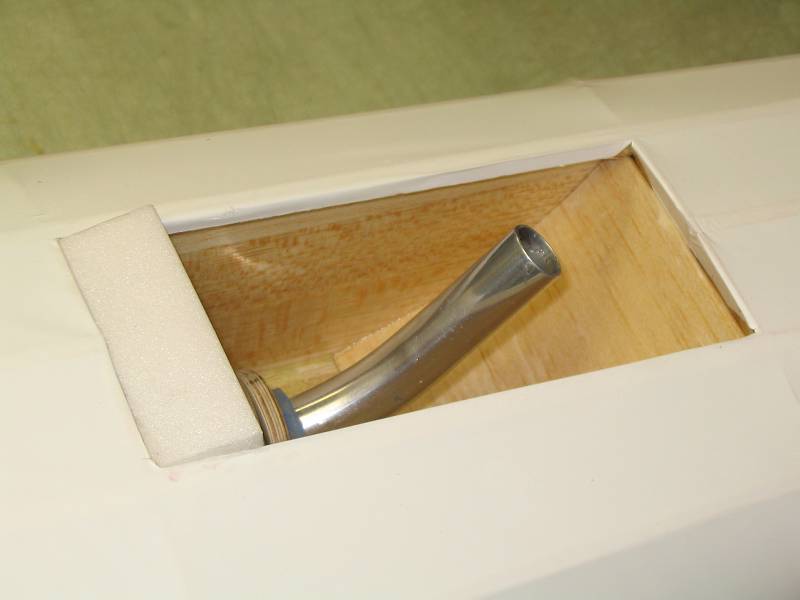

Here is a picture of a simple setup,which we did for the pipe tunnel on a YAK
It is made from Depron
Also -look at the location of the louver groups on the cowling -
These keep the big radial cool on the full scale craft.
They also use inlet doors to correct engine temps -as required.
On the Yak -with the huge radial - they place the prop way out in front - to help reduce the prop losses
On a model such as this one -it also helps admit air into th cowl
On my model - all outlet air is via the open "box" under the cowl and thru the pipe tunnel -to a lesser extent.
I measure the temps of my engines and this one -tho it is subject to a lot of pogo stick flying and I crank the engine HARD- it all stays cool - about 190 is the hottest I see at the cyl fins after landing
Look at the aft underside of the fuselage and you can just see the pipe exit baffle .

Like the Idea of creating a low pressure area at the exit ... I will try doing something like in the picture of the YAK.

Nice work Dick, I notice a lip at the front of the exit, I understand that this is beneficial to the exit flow, often seen in full size cowl exits..is that the reason for the lip on your yak?

The lip and it's shape - is pretty much a matter of what looks good and is easy to do -
Iwould guess some eons ago - air tuft tests showed that the accepted grouping and shape of louvers - be it on the hood of a 32 chopped coupe or the YAK- is "close enough"
The lip causes a turbulance at the aft edge - that's all that is needed - it makes a low pressure and Mother Nature tries to rebalance it -causing air to flow faster to that spot.

Dick, that turbulator strip may be doing things completely differently from what your visualization suggest. It may just be shedding vortices in front of your pipe exit. In fact, you might have been better off just sticking the pipe exit in clean airflow and rely on the venturi effect to create some negative pressure.
At work, our dept. has a group that does quite a bit of single- and two-phase CFD simulation with [link=http://www.fluent.com/]FLUENT[/link]. I was surprised at some of their findings. They often have to correlate their result with some empirical data, because one small parameter change can lead to completelly different results.
If I were to worry that much about this subject, I would try a NACA duct instead of a turbulator strip. I am sure you all have seen the distinctive signature shape of a NACA duct on some race cars. There, it rely on volume expansion to create a low-pressure region, which is much more reliable and predictable.

Well- looking at the oil splatter on the bottom of the plane - the exhaust just makes it out over the aft lip -but it makes it out . I figgered anything that creates a disturbance forward should make a low pressure aft
Those lovely NACA ducts are quite familiar - just don't see a need for em here -
The box the pipe is in flows quite well -just wanted to lower pressure a bit so stuff tends to fly out the hole ---
