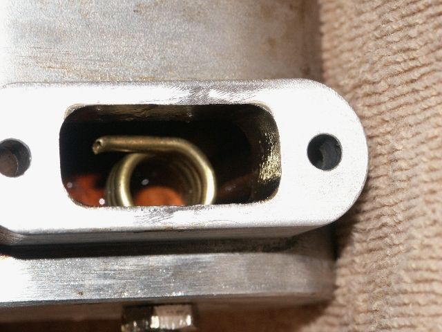

It seems these Bisson mufflers are getting popular lately, but they don't offer a smoke version that I know of. So, I decided to experiment with one to see.
I have a MDS 1.48 on a H9 Tcraft, and I was looking for a smoke muffler for it, but could not find one. Bisson makes a pitts muffler (not a smoke one though), so I pick one of those up and decided to make my own. I'll try it out this weekend and see how it does. :confused

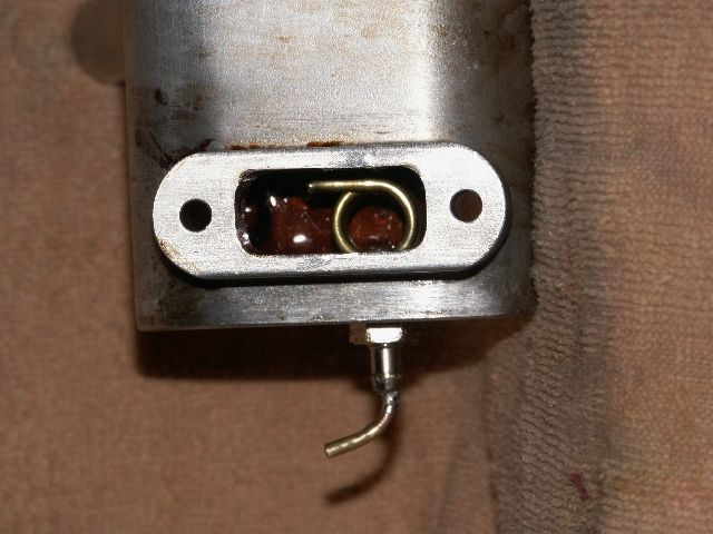

here's another pic

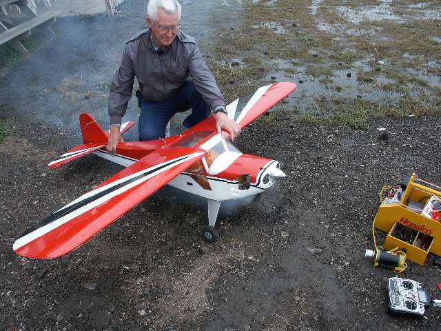

Here is a pic of the intial test run, with a Perry smoke pump. Still need to do some fine tuning of the volume going to the muffler. I am going to try using the pump regulator to ajust the volume. Any suggestions or tips would be appreciated.

Default Bisson (BCM) Muffler - smoke conversion
