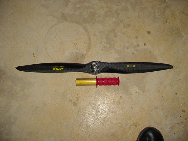

ok the prop arrived safe and sound today so i should have some testing in Saturday
Ps I have been using my heavy duty chicken stick after i felt it was a good thing to have fingers
Tony Bro
yeah that shows what we are thinking if you ask me that box is passing the test but it must be very close to not passing at times
well i need to drill the back of the hub out just a little 7/16 i think so that i can mount that prop. i may go to thesse carbon fiber deals as the grass always starts nipping at my wooden props. I don't 3 d as much as i use to so i don't think i will miss any spool up factor

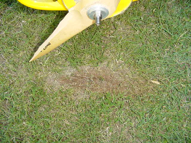

Kick Backs --> A few months ago I had a slightly used engine start to kick back on me. It kicked hard, and often.
I also tried a new and different ignition with the same results.
I bought this engine new, and broke it in per the manufacturers instructions.
I finally sent it to the dealer for a look.
I'm not as good with gas yet, as I am with glow.
The dealer determined that the pistons were carboned up enough to cause the symptoms I was having.
He cleaned the pistions and replaced the rings.
When I got the engine back the pistons were indeed cleaned, and the rings were new.
The dealer never did tell me why, or even mentioned that the carb was changed also.
I knew this because I keep a log of things like that.
The engine is now fine, and I stopped asking questions.

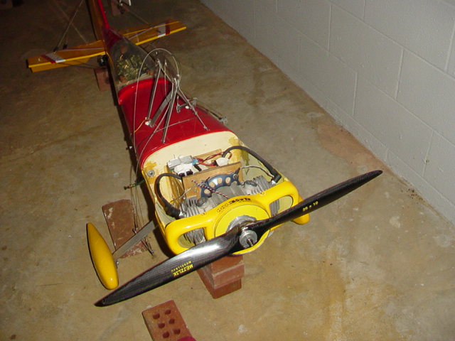

Today testing started good. Easy start up, I am getting 6500 cold on the RPM 26 x 10 Mejzlik the engine is idling about 1500 and slowly creeping down to 1000 RPM. Once I have killed the motor to do some adjusting, here comes the kick back again. I then cut the back out of the cowl to make sure i can rule this thing out. Now the little ignition thing comes a loose on the motor. Well just is finished for today and i am not feeling this motor problem to say the least. I guess this would have been a lost plane in the t-roll with the wire coming off the ignition.

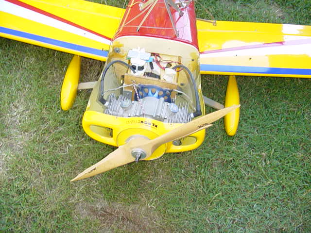

Krayzc
Looking at yer pics makes me ask - Where are your air baffles to direct air over the cans? Also have you looked into your pop-off pressure for your idle issue? Just my 2 cents.
