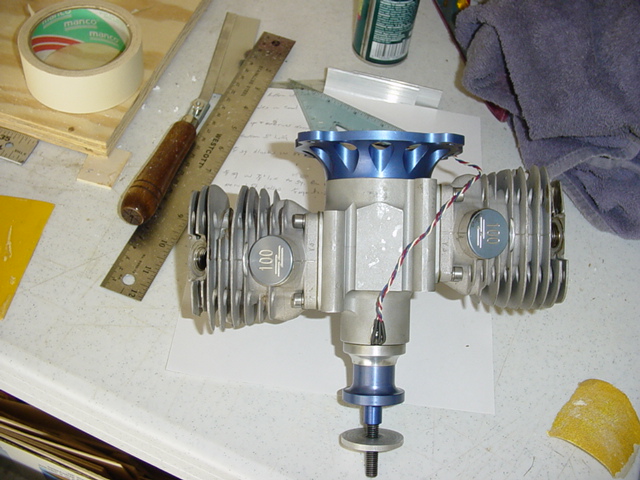

I am back on the grinder after reading about the change over in ignition from BME to falcon. I see were the timing is different. I am wondering is this the way for me?
Well I took my spark plugs out and notice that my spark is arriving about 12/6 o’clock. That would explain my kickback. I loosen that setscrew on the prop hub and make the spark come about 10:30. With this new setting, I try to start the motor, three flips good choke pop, choke off, and she is running. No hesitation no extended idle. I still need to set the timing to the correct spot as I did the (TLAR) that looks about right. I am there from what I can see. I will have to readjust my throttle linkage so that I can kill the motor she is idling at 1200 and the low trim takes here to 1050 were she is still just a running. I am at 6000 rpm by ½ throttle and 6330 at full throttle. I now get instance throttle down on full to idle.

i put on the C & H degree wheel the timing was at 5 degrees. i reset it the timing to 28 degrees and talk about a kickback/backfire in the exhaust on choke. This baby is in bad shape (C & H). I will be converting over to falcon after today. I did not even want to reset it to back were the engine would run once it kickback i packed her up and took a plane to the field to maiden flight....

Heard that ...... apparently the Synchro Spark circuitry that retards the timing for starting is faulty. Main thing is that now your know exactly where the timing is. Now setting up your new Falkon won't be a problem.

I think you have a glitch in your "check the timing setup" a BME won't run 6300 RPM with the timing set at 5 deg BTDC.

First of all, I'd think it EXTREMELY rare (almost never?) that the timing ring hub slips from the factory setting, causing a change in the ignition timing. Even if it is suspected, one should accurately check to see where the timing is, BEFORE moving the ring and changing the timing to something else.
Having said that, I first suspected a flooded engine, caused by flipping the prop with the choke closed, then turning on the ignition and flipping the prop to start it. This is solved by first turning the ignition on, then closing the choke, flipping till it pops, then open choke and flip 3 or 4 more times till it runs. Krayzc was doing that, and still getting kickback, so my next suspect would have been the ignition itself not properly retarding the ignition for starting. As I mentioned before, the CH ignition is timed at full advance, and it retards the ignition timing when you are trying to start it. Krayzc said it ran NORMALLY once it started, which also would verify that the timing was still at the factory setting. The fact that it kicked back pointed to the possibility of the ignition itself malfunctioning, and not properly retarding the ignition during startup.
The fact is, the fuel mixture doesn't burn instantly, rather it takes time for the flame front to travel from the spark plug and completely burn the mixture. Because of this, it is necessary to light the mixture earlier (28 degrees before the piston reaches top dead center) so that the pressure is building and by the time the piston just passes top dead center, the expanding gases exert maximum pressure to drive the piston down the cylinder. Ignite the mix too early (advanced) and pressure builds too fast and actually fights against the piston while it is still going up. Heat builds, detonation and pre-ignition enter the mix and work to destroy the engine. Ignite the mixture too late, and pressure builds too late to effectively drive the piston down. The fire is still burning when the exhaust port opens, and energy is wasted out the exhaust pipe.
That's the reason that tkg wondered about the ACTUAL ignition timing here. Since the CH is set a maximum advance, if the timing was actually set at 5 deg BTDC much of the energy would be going out the exhaust pipe rather than pushing the piston down, and the engine wouldn't have nearly the normal power since the spark is being lit over 20 degrees too late.
Before one can get accurate readings with a degree wheel, the setup has to be correct so that when the needle reads zero degrees, we know that the piston is EXACTLY at top dead center. If one simply sticks something in the spark plug hole to feel the piston coming up, the zero reading can fluctuate up to 15 degrees either side of top dead center, which is a 30 degree swing! This is because turning the crankshaft doesn't move the piston much at top or bottom dead center. One needs to use either a dial indicator or a positive stop to accurately zero top dead canter. Then, all other readings will be just as accurate.
I'm still suspecting the ignition itself isn't retarding the spark at startup like it should, rather, is staying at full advance. That's why it can rev up with normal power, but kicks back on startup. At prop flipping speeds, if the mixture is ignited while the piston is still going up (28 degrees BTDC) the pressure drives the piston back down and the prop goes in the reverse direction (kick back, and yepper, it BITES!). Retard the ignition so the piston is at top dead center when the mixture ignites, and it can't kick back.

OK, I know how a 2 stroke works, so you guys are saying that the advance is set to max and the ignition unit retards the ignition advance from 28 degrees at idle and 0 degrees above 4000rpm.
I was under the impression it was the other way around.
With this said, if the advance/retard fails, then the engine will still run but will be hard to start.
I also said the Falkon ignition is set at 2 degrees BTDC because it electronically advances the timing to the 28 degree BTDC when the engine accelerates. If the Falkon unit's advance/retard fails, the engine will continue to start easily, but will have no power.
I'm starting to think that rather than adding to understanding, I may have contributed to more confusion regarding this stuff. I do know that proper ignition timing is one of the key ingredients to having an engine that runs strong, and runs happy. Without understanding, it is easy to get things out of kilter.

OK, now I know we are saying the same thing.
The only difference is that I thought the C&H unit worked like the Falkon unit and it doesn't. They work opposite
