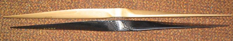

rmh's Avatar
rmh
Posts: 12,630
From: , UT
Default RE: 3W-75 Engine
Max torque is a moving number - it changes with exhaust system setup used .
I have two different ZDZ80's and on same tuned full length pipe one turns 300 more rpm - the stock one 7000-the modified 7300
same Mejzlic prop so torque obviously moved up.
The mod engine also turns 26x12 ZM, 6450 on the ground and 7400 in level flight in a H9Edge . on big JMB can ,NOT tuned pipe.
I really don't know if any 100's can match it . Maybe they can -but have not seen one .
Note the 1.25 thick hub on the 26x12 -
Onboard tach verifies real in flight rpm.

OK--finally got to do a run up and tack---I live on the gulf coast, at least for now. Anyway with a Bambula 26-10 prop I get 6060 on the ground. The spec sheet states 1100 to 8100. Think I'll change the prop. Any other suggestions would be appreciated.

Put a little less blade on it, try a Mejzlik 26X10 carbon prop , they tend to be a little less load than the wood wide-blades. You should be around 62-6500, make sure it's not too lean, see if there is a good tan on the plug, if not, fatten it up a 1/8th turn on the high side.

I would agree, 26x10 Mejzlik or Menz would be in order.
