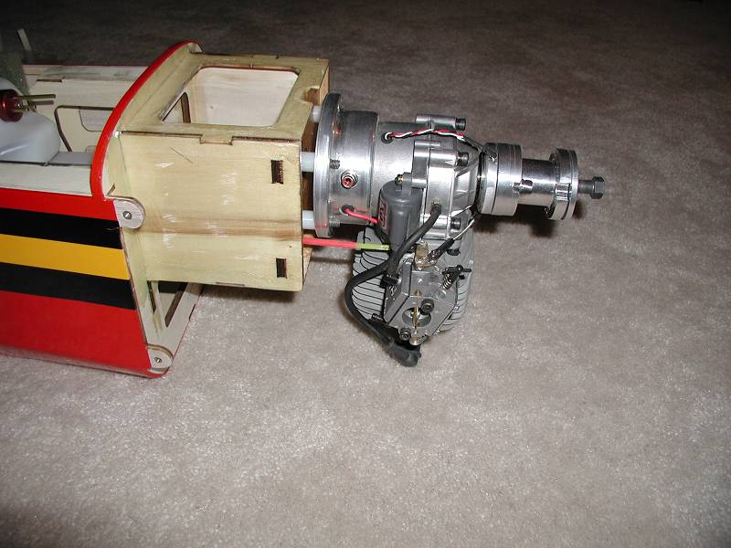

i plan to do mostly aerobatics and maybe experiment with some 3-d. How much would one of these ignitions cost. I am a machinist thought maybe i could make prop hub out of titanium?
Old 12-21-2005 | 08:41 PM
Antique's Avatar
Posts: 9,825
From: Somewhere, DC
Default RE: G-62
Here ya go, a picture is worth a thousand words...The hub is 2 parts held together by 4 grade 8 10-32 allen bolts, the prop bolt is grade 8 3/8-24...

A couple of shots of another of Ralph's G62's mounted on a Wildhare Extra. Hope you don't mind the pictures Ralph. [8D] I think you have changed the design of your hub since this one was made.

The new hub goes with the electronic advance and is part of the weight reduction...I also make the mount smaller on the new ones for a little less weight....
