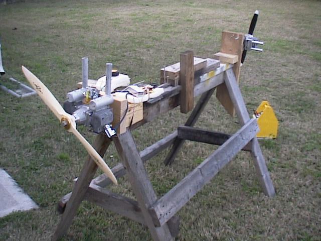

Volfy's Avatar
My Feedback: (23)
Posts: 3,227
From: Houston, TX
Default RE: What are you using for a test stand?
My test stand is a sawhorse made of 2x4s. Cheap, effective, and I've had everything from a .32 Wankel glow engine to 100cc gas twins on it. Accomodating odd setups like big long tuned pipes is no problem. All it takes is some 2x4 and 2x6 scrap pieces and a screwgun.
To me, safety means the test stand must:
1. Be extremely sturdy
2. Be able to mount engine securely, preferably using the exact same mounting method as on aircraft
2. Place the engine at proper working height (slightly above waist level)
3. Be able to mount the engine in various orientations (to make access to adjustment points easy.
4. Be able to be reposition and relocated as required (for example, so the exhaust blows downwind)

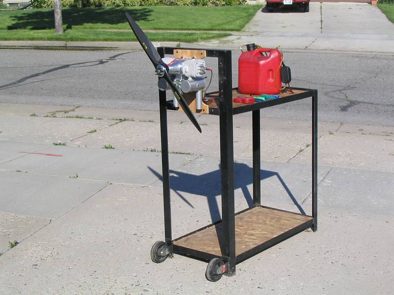

rmh's Avatar
rmh
Posts: 12,630
From: , UT
awwww-

exeter_acres's Avatar
Joined: Sep 2004
Posts: 7,457
From: Johns Creek, GA
ORIGINAL: dick Hanson
awwww-
I actually like that stand...but if you put a couple more wheels on it....you could tool around the neighborhood

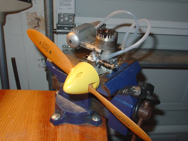

Joined: Aug 2005
Posts: 182
From: Bradenton, FL
ORIGINAL: krayzc-RCU
test stand what is that?
i guess i have been using firewalls?[]
LOL, A truly honest man!!
Me too! Although I've been known to use the vise mounted on my worktable.....

rmh's Avatar
rmh
Posts: 12,630
From: , UT
It has retracts -

Flip and Fly's Avatar
Joined: Sep 2003
Posts: 652
From: Gatineau, QC, CANADA
Dick, it looks like you just pulled in from another nice drive in the country.
Old 12-17-2005 | 06:10 PM
My Feedback: (25)
Joined: Aug 2002
Posts: 649
From: Dayton, NV
Looks nice Dick,can you hover it.
