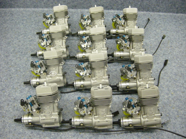

Sorry, I have been informed that it sometimes takes a while for the server to be updated. So I am showing a pic of the new engines for now.

Weight with standard muffler...?
Cost....?
Warrenty...?
Suggested RPM range...?
Suggested props...?

Where are ya importing those from?

Supertigres are now made in China...I would think Keith would insure that they will be made to the same high standards Supertigre has always been known for....

I wonder, do they have a bushed, or needle bearing con rod? What will be the oil requirements?

This makes no sense to me.
Whats the point of a gas engine in .90 size? Can't be fuel economy. A 90 doesn't use that much fuel anyway.
Another thing:
I asked a question about putting needels on the rods. The consensus was that it would wear out the crank pin if you put needles in the rods. Wasn't worth the extra $3 to put bearings on the rods. People had done it before and it just wasn't worth the hassle.
Now we see this little bitty .90 engine and people are speculating that it's got needles on the rod.
If it DOESN'T have needles on the rods--then it's pointless. The methanol in glow fuel isn't the expensive ingredient. Nitro ain't too bad either. It's all the darned OIL that makes glow fuel so expensive.
So--if there are NOT needles on the rod--then you'll be running 10% oil or more. There goes the price of your fuel again. Might as well be running it on glow and save the weight and cost of the ignition.
I am real interested to know if it has needles. Also interested to know--Whats the point of it? A .90 size gasser?

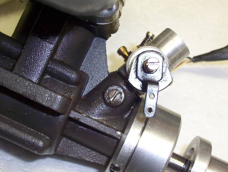

Well, there is a gasoline .61, my Merco .61 here turns a Graupner 12x6 at 9,100. It requires a little castor in the fuel or it gets hot and quits.

Guys, this engine was built by us to run as a gasoline engine at 50:1 mix. It produces more power than when run as the stock version on glow. The rod has a needle bearing and the crankshaft utilizes a hardened pin for use with a needle bearing. This is not the worthless conversions you may have seen in the past and has been tested for countless hours without failure. The reasons for an engine like this are endless. They are for sale at 369.00 with supertigre muffler and electronic ignition
1. Economical to operate will run up 30 minutes on ten ounces of fuel at 50:1 mix
2. No oily mess to clean up
3. All components are custom built for gasoline operation
4. Pump style carburetor so place the fuel tank where you like
5. Superior idle and throttle transistion with no deadsticks
6. Electronic ignition so hand starting is easy with no need for glow plugs and glow drivers or field
support equipment
7. No weight penalty the engine weighs 26 ounces and the ignition and battery weight is offset by the
reduced fuel capacity.
8. No rusty bearings due to the hydroscopic glow fuel
9. More power than the glow version all in .60 size case and weight.
10. Some countries cant get glow fuel or nitro and are begging for a small gas engine.
11. Fuel savings will pay for extra cost of the engine.

We have also developed a gas version of the .51 Supertigre and the 2300. They dont run hot at 50:1 mix and I challenge you to wear one out. The .90 turns a 13x6 APC at 12,500 -12,800 rpm on gasoline and stock Supertigre muffler.
