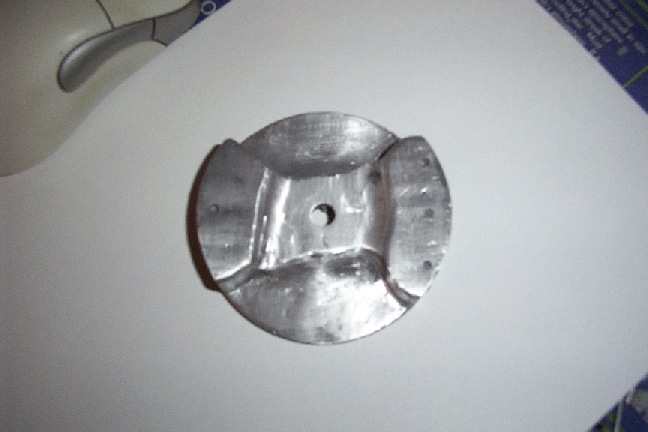

Here is the rough draft of my flywheel lightened up a bit. Still have to smooth and balance it.

Thanks for posting, Milton. How do you set the timing, do you just place the magnet in the flywheel when you firt set it up? I don't have a lathe, but a friend does. I have no clue what the flywheel/prop hub design is like where it mates to the shaft. Is anyone willing to post some blueprints?

Milton: Is the fly-wheel more of a ring with a place to mount the magnet to trip the pickup sensor? Can you post about the same photo with the complete prop adapter in view...using about the same camera angle? Looks like a nice set-up. I did see a post when a guy bought the Falkon ignition for uner $80. You are right...they upped the price. I am reading a few ignition designers(group effort) will have a do it yourself ignition system with parts that can be bought for a total of under $40 sometime in the next few months. Capt,n

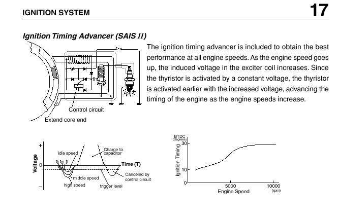

Here's how the Stihl slope advance ignition system works:

Does that mean my three-magnet Poulan 46 HAS some timing advancement?
From the diagram above it seams similar...
Good Thread! Lot's of cool info out here...

my poulan 46 mag and coil setup (stock) have timing advance so yours should to just look at the bottom of the coil and see if it is a type MA.

Does the 46 need the cooling fins below the exhaust port? Most of the aircraft engines don't have any and this motor was designed to run in an enclosure. Just looking for lightening and opinions.

h82crash the most on can really save from shaving the head is about 2 oz. most are shaved for cosmetic reason not for much weight savings I would leave it alone.

don't mess with the cylinder head, lighten up everything but the head...... you can probably polish them to get better cooling, but don't shave em, concentrate on the rest of the engine, for example flywheel, piston rod, piston, but be carefull, I would probably give the engine to a professional to blue print it

When I read to balance the flywheel after cutting the fins off, balance how? Like it was before cutting (heavy on the magnet side), or balanced evenly?
