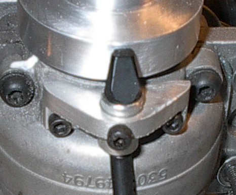

Got my poulan 46. Haven't taken the saw apart yet, but what is everyone doing with the shaft on the rear of the motor? Do you cut it flush with the crankcase? Can anyone post a picture of the sensor mount on the CH kit?

JUST CUT OF THE THE SHAFT...... U DON'T EVEN HAVE TO TAKE THE ENGINE APART JUST TAKE THE CLUTCH AND THE BELL OUT, AND CUT IT

carefull when cutting on crank shafts you need to do it slowly or the heat will melt the rear seal.

Here ia a pick of Poulan with Falkon ignition, It weighs 3lb 9 1/2 0z as you see it without engine mount.
Milton

Milton, that's light. Did you have to make your own prop adaptor? Is the sensor mount standard or custom? What is the cost of the Falkon?

The only thing custom is the mount for the sensor, The Falkon ignition were bought about 4 months ago for about $80.00 but they have gone up to about $110.00. the flywheel and prop hub were made on a lath. I might use C-H on the next one I do if I can find out why the Fox I have has the timing set at about 4 deg ATD and not 28 deg.
Milton
