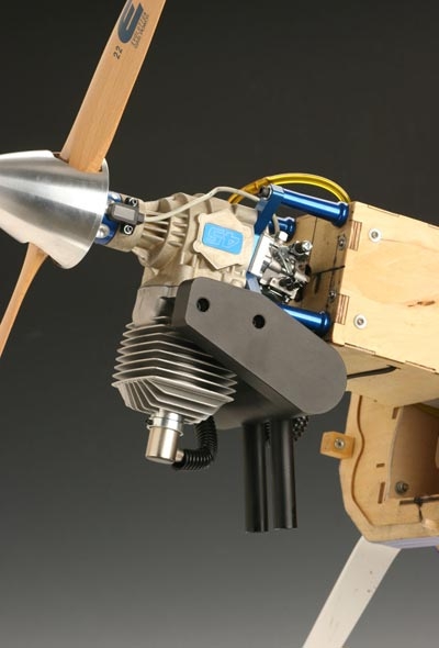

I'm getting a BME 30% Yak in a few weeks. What engine should I use? I was thinking DA50 or MVVS 45cc.
I've heard that the DA50 "burbles"?? I 've heard the engine and I must agree that it seems to make a missing sound or a burble sometimes. But I also hear that they (Desert Aircraft) has the best service. But i can't find any in stock. DA says 3 to 4 week wait.
I've also heard of nothing but good things about the Mvvs. Powerful, reliable, light weight. In stock available for immediate shipment.
I need sojme advice from people that have experience with these engines.
Thanks in advance
Mike

I also looked at DA and MVVS/Evolution 45. I have no doubt that the DA (I've made offers on two this week here) is a fine product with some of the finest customer service you could ask for.
Think about a Taurus TS52. I like the idea of a double web crank and a bell mount included (no standoffs required). Do a search on the internet and see if you can find one bad comment and then decide. I went through the same process and have one on order. Taurus had a price increase in December but it is still a good value.
Here's the process I went through...
MVVS (Same as Horizon's Evolution 45GX): Not much history
DA: Most history of any late model 50cc. Mostly good reports, but the one I see at our field is still not dialed in and I have heard about the mid-rangle burble/deadstick issue a lot as well. Granted, these may be user related problems and DA will back what they sell. I personally don't like 2 or 3 inch standoffs.
Brison: Good motor! I owned a 2.4, but there has been some changes at Brison...
Fox & FPE: I don't know. To me they look like a Brison copy.
BME: I hate beam mounts on a 50cc motor.
ZDZ: Good for some, not so good for others. I had a 40. Do a search....
3W: I seriously thought about the new 55! I have not heard any user reports yet and all I could get from AA was cannister data.

First, go with a 50cc plus, not a 45cc. More aircraft options later.
Second, there are a lot of great engines out there in this size range. It will come down to fitting your budget. Fox, First Place, Brison, BME, 3W, Taurus are a quick few I can think of, and not necessarily in that order.
Third, that "burbal" you hear about is directly controlled by the needle settings input by the user, and the stage of break in the engine is at.

I would think for a 30% a 45 or a 50 cc would be under powered.
Have you looked at the Evolution 58? That would really give your plane tons of power, it can swing a 26x10 @ 6000 rpm, and a 24x10 @ 7000[8D]

This is my first gas airplane. The Mvvs 45 is supposed to have slightly more hp than the 50 DA. (5.2 vs 5.0)
So getting the larger displacement engine doesnt make sense unless it makes more hp.
I don't think either will under power a 16 lb yak. A friend has a TOC Yak with a 50 DA and it has awsome vertical.

Mike, just keep in mind that the MVVS does not come with standoffs so you will need to make or buy some. It is also designed to be run with a can. All bets are off if you use an in-cowl muffler. You might be down several hundred RPM, and in the giant scale gas world that is huge. On some of the Yaks you can put a can down the bottom of the belly if you cant the motor.
On the plus side...Horizon is already stocking parts for it.
Keep us informed. It's a big choice! Been there...still doing it!

Thanks for taking the time to help. The BME Yak has a canister tunnel. So that's not a problem. But I hear it's a pain in the ass to get everything lined up with the thrust lines etc. Mvvs has a engine mount available on their web site. So no stand offs. But no Pitts style muffler which would make the job easier.
I like the fact that DA has everything I need for installation like standoffs, mufflers, (or cannister if I want). Seems to be less of an issue . They just are'nt available. DA seems to be more of a popular motor so I can get help easier.

I'd go with a can. DA has wraparound headers on their site. Horizon also carries a Bisson muffler for the Evolution 45GX which is the same as the MVVS. If you are down to those two I think I'd lean towards DA simply because there is little data out on the MVVS. Yes I know guys say it turns this or that RPM with this or that prop...but for how many years? That was a factor in my choice.
Here's the muffler... Oops. Horizon updated their site since yesterday. They had a pitts on a 45 in a H9 260. Here's the number of it anyway: BIS05545 Inverted Wraparound muffler I have the picture saved at home. I'll post it later.
If it was me, and I had the money and could stand the weight I would go for the quiet power of the can setup.

I'm going to step off the beaten path with this one. You're starting baseline is 30%. Okay, great. You're looking at 45 to 50cc engines, but have started to move toward a 58. Again, great. Now the side step. Why not compare some weights and prices and consider a Cunningham converted G-62? Weight is inline with the 58. Power is probably equal to or better. Reliability is a lifetime given. I have no idea where Evo will be tomorrow. Price is comparable. Ignition warranty is lifetime with RCIGN. Later uses is higher with the 62. Availability is likely sooner with the 62. Getting full and easy access customer support is a high priority with the 62, not that yoy will need any.
My choice at 30% would go to the Cunningham G-62. It's quite a bit more powerful than the DA50, (quiet, DA owners) with no known reliability issues. The base engine has been in production for decades, making parts availibilty a non issue.
