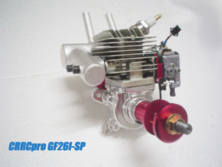

Or alternatively you could try with this engine...just giving options...
