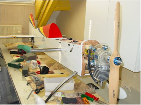

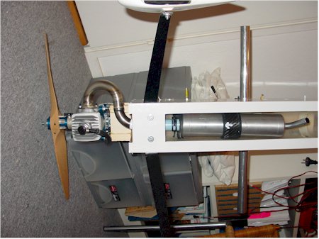

LeBlanc,
I have it in a 2m ship and it is superb. So much better than the ZDZ40 and Brison Revolution 52 that I used before on that model.
Not only has it more power than the other, the smoothness is a highlight with this engine. I do not understand why Horizon does not advertise with it.
It is a pity that there is no rear exhaust version available.
