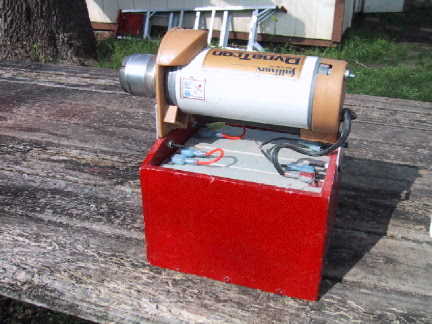

what starters are available for 80cc gassers? is there a battery set up that would allow a dynatron to spin 'em without killing it in short time? the starter that is.

locoworks, here is a site that list Miller R/C Products which produces high torque starter accessories. My Dynatron on 24 volts will spin a G-62 but havn't tried it on an 80. Probably would though since it is consuming 4 times the power that it does on 12 volts.
http://www.thercsource.com/misc.html
I'm just curious. Why do you want to use a starter on an 80 cc engine. Most large 80 cc engines have electronic ignition which fires at idle near 0 degrees BTDC. This allows easy starting with no kick back. At least that's the experience that I've had with my Brison 5.8 and 6.4. I don't see my friends using a starter on their ZDZ-80s.

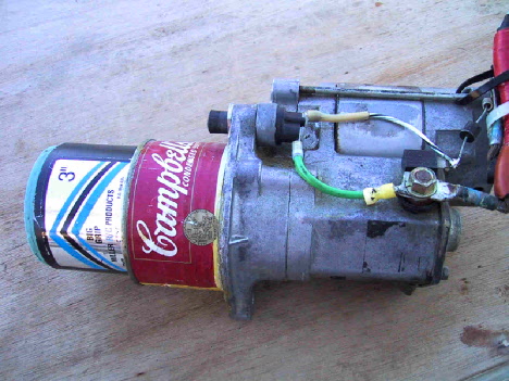

When things get serious, I drag out a serious starter. I converted this one from a Nippon Denso starter that was used on a Mitsubisi (sp) V6. The conversion consisted of removing the gear which engages the flywheel, taking the front end (the end next to the engine) apart and removing the spring which retracts the the gear then reassembling the front end. Next I drilled a half inch hole in the Miller R/C Products 3" drive cone to match the output shaft. Then a set screw hole (10-32) was drilled in the side of the cone. Next, several washers were put over the output shaft, the shaft pulled forward, and the cone installed. They shoulder against the output bearing on the starter and the back of the cone. If you don't pull the shaft forward then it will not be engaged. The Campbells soup can was used as a guard to keep the socket head set screw from knocking the c**p out of my hand.
Over all this starter is better for large engines than the Dynatron on 24 volts because it has far more torque, due to the gear box, at much lower speed. Of course it works on 12 volts. I haven't tried it but feel that it would turn a 240cc engine over without even breathing hard.
Ken
