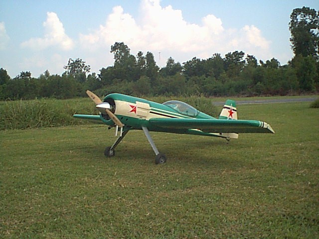

You definitely don't want a G62 and the 26 and 38 won't be enough. I had one ( sold it ) witha g62/22X10 and while it was a power monster it was also waaay too heavy.
