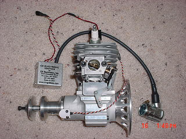

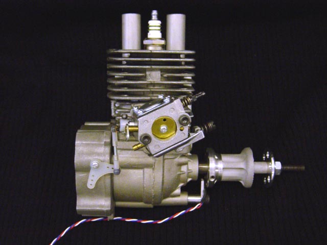

I just purchased a Zenoah G38 and would like to know how to set up the throttle. The throttle butterfly runs east and west instead of the regular north south direction.
Old 08-01-2006 | 08:46 PM
My Feedback: (29)
Joined: Jan 2005
Posts: 1,402
From: San Antonio, TX
Default RE: throtle servo
Her are a few pictures./ Just use a bellcrank and a ballink.
Dave
