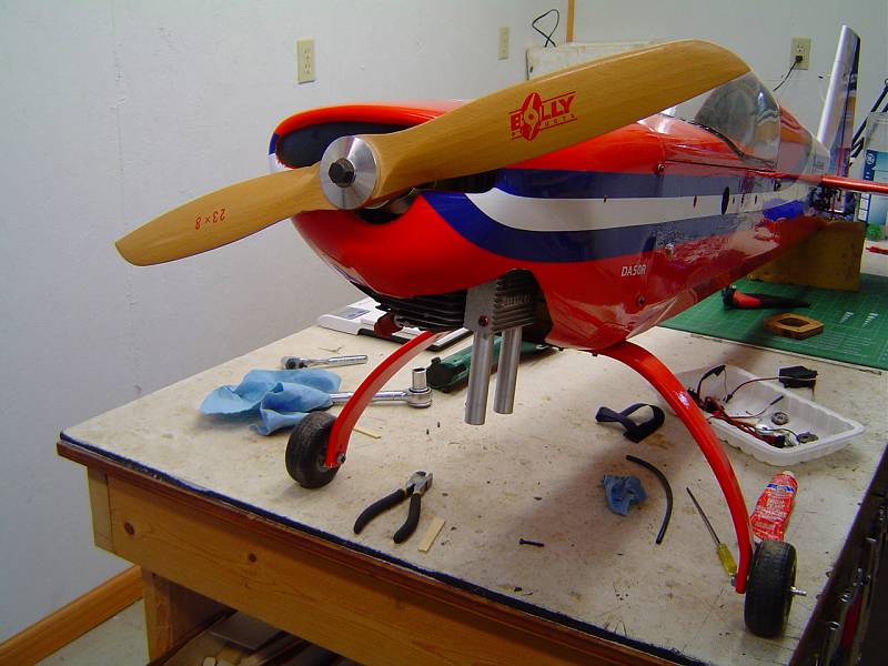

Wow, what timing! I just got my G62 back from Ralph last Friday and got to fly it in my WH 28% Extra for a few flights yesterday. I'd be willing to say that I've got more hrs on DA50's and G62's than most folks. Ran two DA50's with over 30 gallons through each of them. Had one G62 on a Giant Stinger for 60 gallons.........I've sold both my DA50's, and got a stock G62. Learned how to "slap" start it and everything. If flew my Extra with authority, every bit as well as the DA50's, but no inverted richness problems, no rod knocking, and no sending it back for that great customer service. If I was looking to get into the 28% stuff now, I would go with one of Ralph's light G62's hand down! Mount the thing and fly the snot out of it. No service required. They even start hot! Here's a few pics of my stock G62 firewall ready, then the muffler seperate. The scale can only weigh 5 lb. 4 oz. max. The pic with Ralph's engine has the same muffler on it, an 1100 NiMH battery pack that weighs 3.5 oz., and also has the Radio Shack battery wire on it. No switch weighed since I had a kill switch mounted for the stock G62, that makes it a wash. I'll see if I can dig up my rpm numbers, but I know the stock G62 beat the DA50 by 300 rpm or so on the Menz S 22x10 and the Mejzlik 22x10.
I lost 8 oz with Ralph's conversion. That let me remove the two servos I had in the tail of the WH and go back to one on pull-pull. That's a 2 oz. savings for servo, then about another ounce for hdw. That makes the plane 11 oz. lighter. I'm sure it's real close to what it was with the DA50 in it.
Here's my rpm numbers........
With 3 gallons of gas through it. B&B muffler, Stihl oil @50:1. Broke in with 2 gallons of 32:1. 50 Degrees.
22x10 Mejzlik 7350
23x8 Mejzlik 6750
22x10 Menz S 6650
22x10 Bolly Wood 6900
22x8 Bolly Wood 7050 cut down 23x8

Here's a pic of my Extra with the stock G62 in it. I used a velocity stack, but the carb was inside the cowl. With the conversion I didn't put the V-stack on and I have zero blow by..............

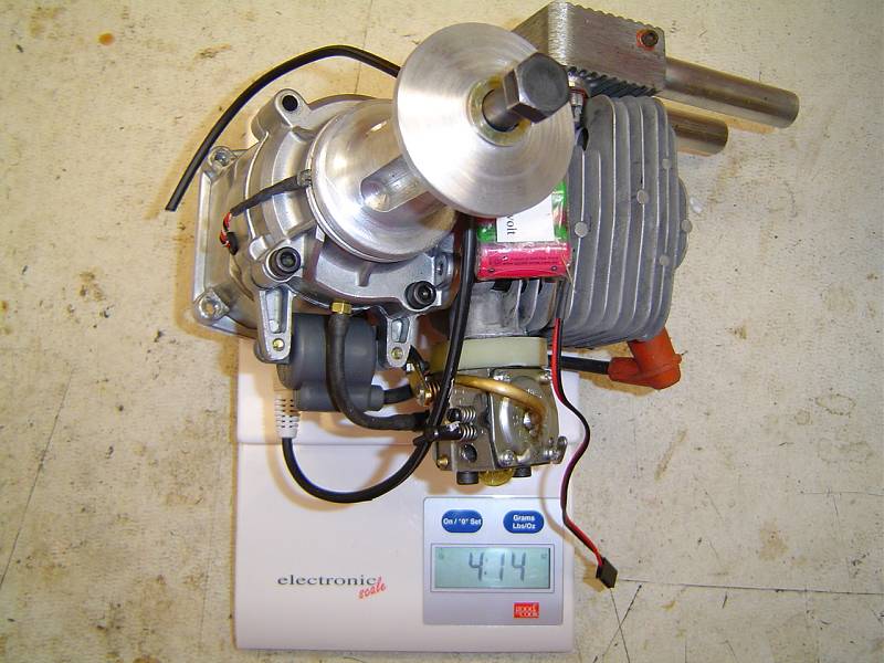

Notice that the weight pic that Johnny J. has provided includes the weight of the ignition module. I'll venture that the DA engine weight does not include ignition.

A DA50r with ignition module, standoffs, prop bolts/hub, stock muffler, comes in at 4.14 pounds ready to fly,, that weight on the
G-62 is 4lb 5.5 oz,, I don't see the muffler on the scale or the engine mount,, just out of curiousity I would like to see those up there for a weight,, and if everyone thinks about it this is not comparing apples to apples,, All DA fans take it as a compliment to be close in comparison to a engine that is 12cc bigger,,,,,,, if you guys want to compare apples to apples go compare the G-62 to a ZDZ60 the ZDZ would out perform it in about every way,, I think the G-62 is a great reliable engine, but think about the comparison issue, just my .02cents......
