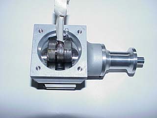

>>The ZDZ motors also have the advantage of a shorter, stiffer, and more durable crank.
Uuuuh, the crank is what I like least about the ZDZ40. They use a cantilever crank that I view as a step to reduce cost, not the optimal setup for one of these engines. Taurus uses a double web, forged, single throw, fully counter-balanced crankshaft. IMHO, this design is vastly superior to the ZDZ cantilever designs, both for strength and lack of vibration.
