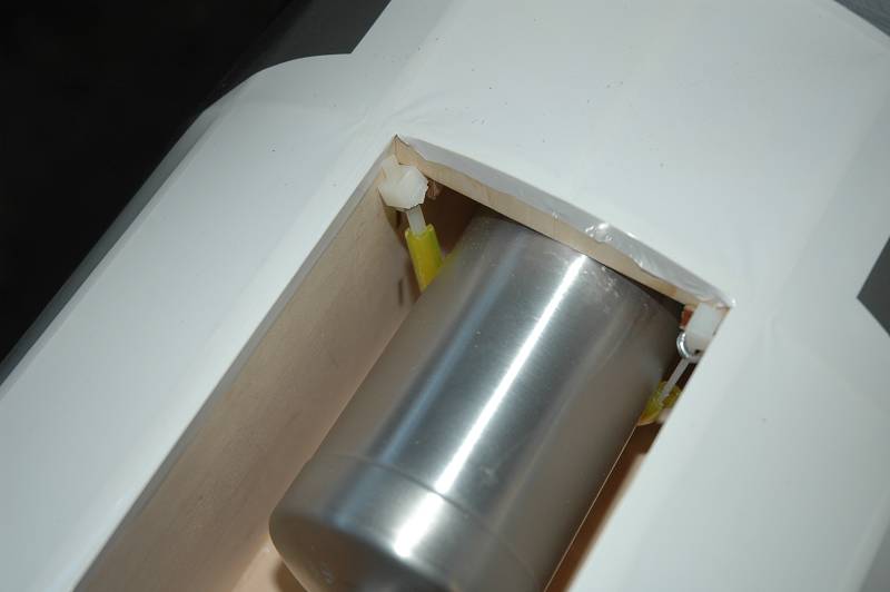

I am holding up the cannister as shown in the pics below. I am assuming that tygon will be able to withstand the heat from the exhaust. Appreciate any feedback

Tygon will melt!!!! Its plastic
Use silicon if not exposed to the exhaust or neoprene.

You are right...will silicon tubing work? Like those nitro fuel tubing?

As tkg said, silicon or neoprene.
I have been using silicon tubing (fuel tubing) on my canister set-up without any problems. Though the tubing is on the canister itself and not exactly where your's is located in the second picture.

Yes. Use glow fuel tubing. It's silicone.

Thanks folks, ,I forgot about tygon...will use silicon.

I'm pretty sure the silicone tubing will still melt in those locations, and the tie wraps will certainly melt and split. I have two MTW TD125 cans in a KatanaS with a Kroma180i in the nose. These cans get so danged hot, I had to but header wrap around them where my silicone tube pieces but up against them.
