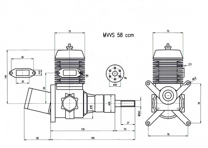

HAS ANYBODY DROPPED ONE OF THESE GASSERS IN A AEROMASTER? I NEED SOME HELP. ANY MODS. NEEDED TO MAKE IT FIT, IE: CUTTING THE FIREWALL, STANDOFF LENGTHS....ETC....

fmnspooch,
You will have to cut a hole in the firewall to clear the carb. You will either buildup the firewall with plywood or use short standoffs to get the proper prop position. Here are the engine drawings and Aeromaster manual.

Guys, thanks for all the input, brought the fuse to my field today w/the motor, the guys were drooling fromt the mouth. Did all the math, Im going to build up the firewall 3/4" and use the 45mm standoffs. It will give me the room I need for the rear carb setup and almost 1/2 in of breathing room for air intake. I just need to move the cowling as far forward as possible.
