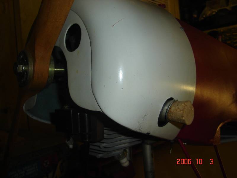

I use a velocity stack, and a cork on my Dr-1. Works pretty good.

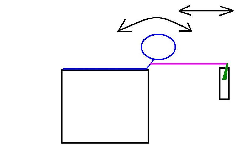

Some how I think choking the cylinder to death will not work I have ordered a carb. There is not enough room for a velocity stack or to get anything in there to cover the hole; and because of its location and the way the nose was built I couldn't cut a hole in the side if I wanted to (which I don't). Using my starter on that flat prop hub is probably out also.

You ever seen a choke plate on a 4-cycle glow engine? It's just a little flapper on a spring. You put a finger on the flapper plate and it closes off the carb.
Maybe you could do the same thing with your carb. Use the carb mounting screws to hold a little ring on the face of the carb. Rig up a little metal or balsa flapper on a hinge and put a piece of rubber on it to make a seal. Rig it to a servo and a linkage.
Crude paint image:
How rude goldberg is that?
