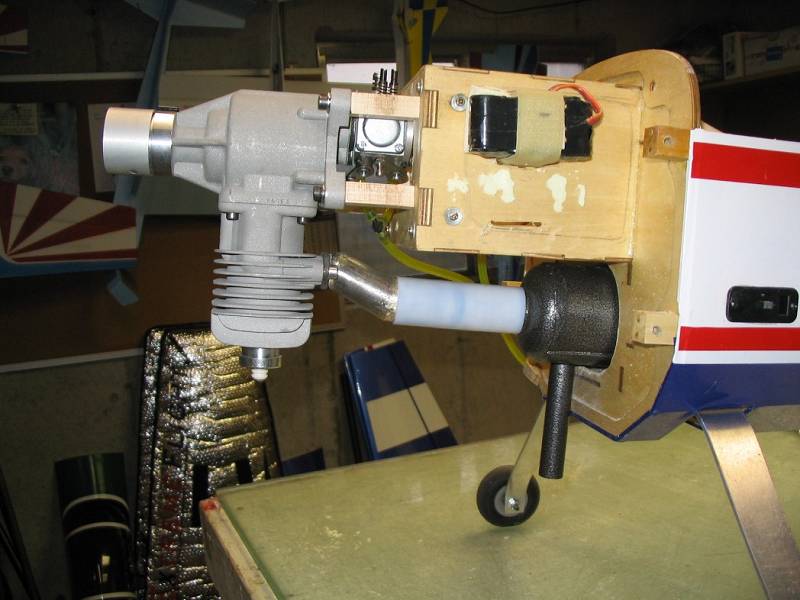

One of the slickest engines for warbirds this size --is the ZDZ40 RE (rear exhaust ) the entire engine will fit in a 3" wide cowl
HOWEVER
Warbird guys--- unless they have a background in performance flying, are notoriously bad about figuring out airflow and the idea of a can or a pipe - seem sacrilege.
here is shot of one of these with a muffler can - which does not limit power and sounds great and is not a tuned device - with this setup a 21x8 Mejzlic prop puts out excellent power - around 7000 rpm (as an example
So depending or your preferences - opt for a good industrial modified engine ( more cooling fins but a side carb and a siade exhaust ) or for full enclosed setup get the 40 but you must do a good cooling flow setup internally or you will cook it .
HOWEVER

How far into the fuselage does that muffler can extend? Are there issues with heat inside the fuselage?

The can is 12" long .
For a scale setup there needs be an inlet -on the P40 that's no problem and a big angled exit undeneath
I think the P40 had large bottom cowl flaps -
as for can heat - as long as the bottom is open no problem
Heat comes when you try to cram everything in a tunnel

I would go with the 3W 55i. Rear carb, I don't think you would cook it if you leave allot of exit area for the air and don't cut all the front opening of the cowl out. Just enough to let air into the engine.
From what I have gathered its 1-3 ratio for intake area vs area for exit air, or about.
Plus lots a room in that bird for a in cowl muffler, nothing sticking out but pipes I would think.
A simpler setup would be a G62, they are very reliable, and I would get one with electronic ignition, they do start better.
