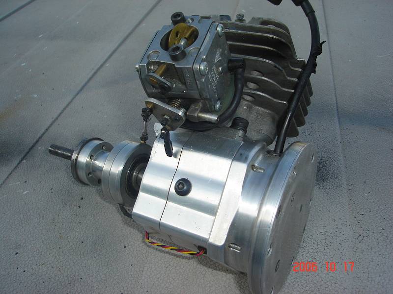

Just aquired this engine for a "reasonable" price. Was listed as a Walker 4.2. Looks like it may be your ignition conversion. Is it?

My conversion but more likely an A&M engine.. Walker engines had a white delrin ring on the front for the sensor..
Look at the con rod, if it's copper colored the crank is a Sachs..Walker 4.2s have the top 2 crankcase bolts parallel to the bottom 2, A&Ms were not...The cases are otherwise identical, and if the crank is a Sachs the engines will run the same..A&M cranks were not known for their longevity....

Thanks Ralph, thought it was. It definately has a Sachs crank, and you are right, it is an A&M. Always wondered how to tell a Walker from an A&M. Already know the crank ID, and all about the "soft" cranks. Seems their reputation, makes even the ones with a good crank reasonable to buy. I don't need my ego soothed by a "label".
BTW the plug wire insulation has been burned by a rear muffler. Can it be removed from the coil and replaced?

The coil is a Zenoah/Red Max, same as a G62 but with a longer wire. The wire is molded in...You can probably put a few layers of heat shrink over the wire and keep it away from the cylinder somehow, it should be OK....
