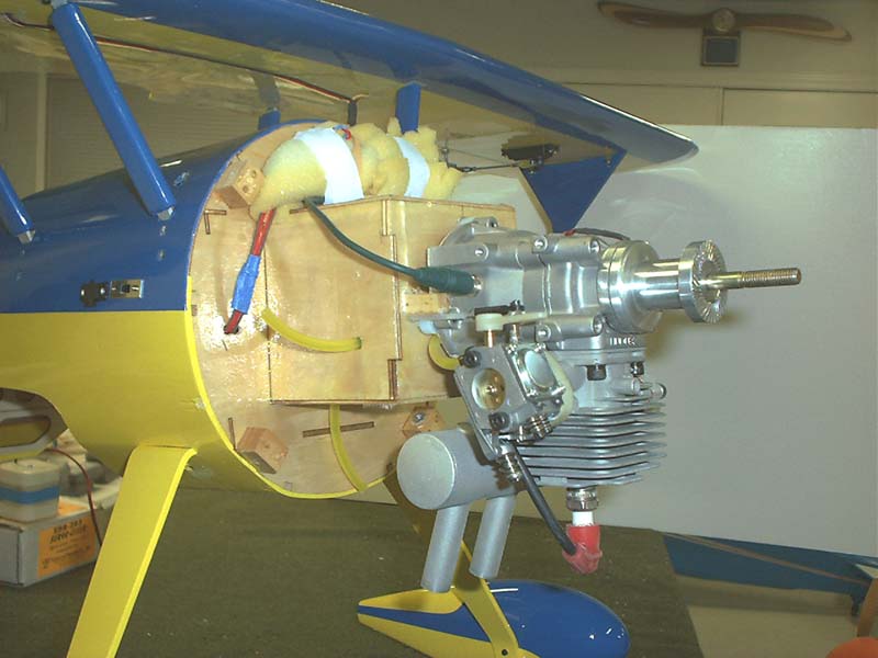

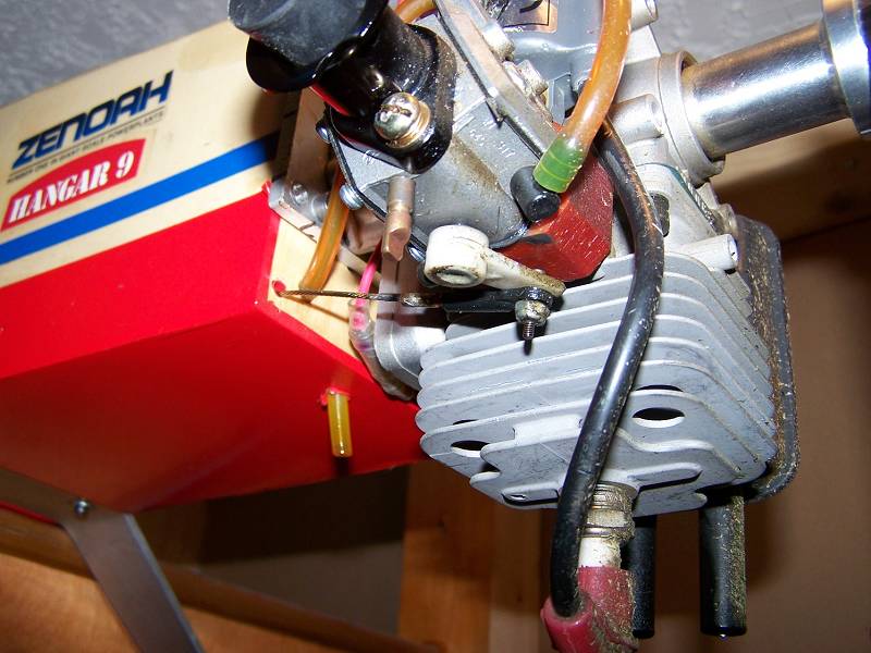

Do you have any photo's to show how you set up a linkage on the throttle?
Mike

This may not be the best way but it worked for me. Doing it this way I kept the origional throttle arm and stop on top of the carb.

L48: Is that a regular ignition coil on your G26? What ignition are you running? Thanks Capt,n

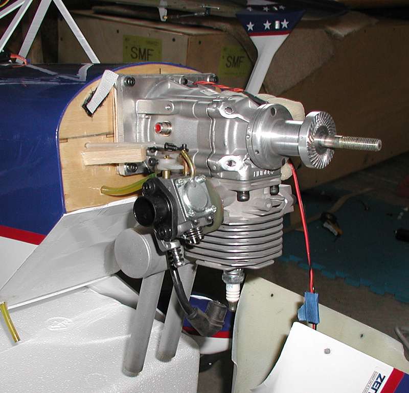

Here's another way.

Gents, thanks very much, the pics make it very clear on how to set up bell cranks.

It is just the stock mag. ignition set up from Zenoh.

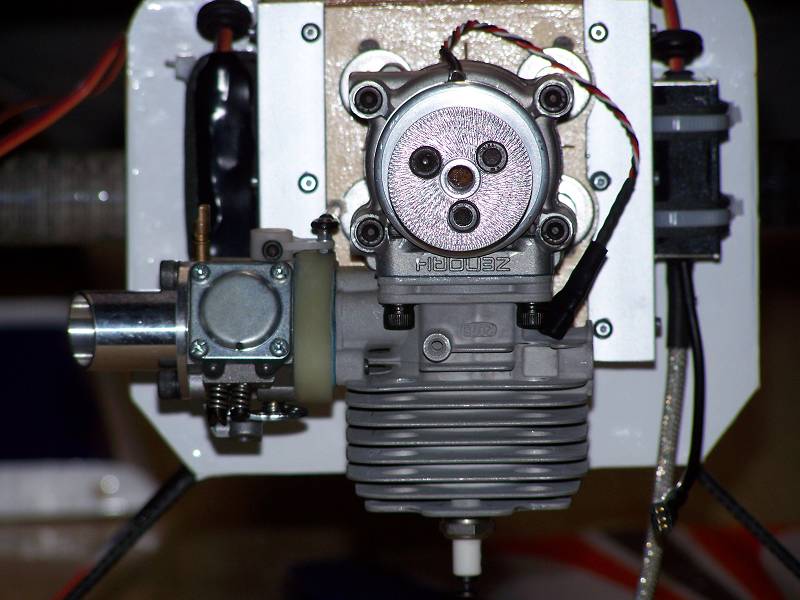

Hear is my setup, I do like antiques bellcrank also.

Looks like you have your G-26 on a Hangar 9 Ultra Stick Lite also. As you can see by my picture it is a little dirty, it flys alot and is a great plane motor setup. From your picture looks like it is new, if you haven't flown it yet your in for a treat.

L48 she is new almost ready to fly........... and Lexmar I used fairly large triangle stock with 30min epoxy.

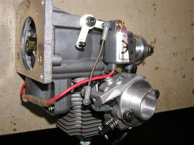

One more for you to look at

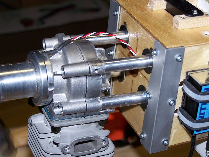

My 26 looks a little different. It's a RCIGN converted 26, but I took it a bit further

RTK, tell me about putting as servo so close to a gas engine with electronic noise.

Arobatx, thanks for the pic's on setup and reinforcing the fire wall. Good job, but how about a pic on your throttle set up?

I always do a engine on/off range check and the difference has always been less than 10%. To date I have not ever had a problem with feed back or glitches. As long as it range checks you will not have a problem.
You are correct though, more distance is better....

All I have is a front shot of the engine, but if you look close, you can see the throttle arm (on the top) and the linkage goes straight back into the firewall.

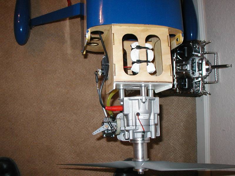

I have several pictures. Sorry they don't go into more detail but maybe they will help.

Have you flow the pitts yet? Curious what the all up weight ready to fly is, and what you think of it?

It might be difficult to tell by my pictures so... which Pitts? They are both different Pitts models. The S2B or the 12?
