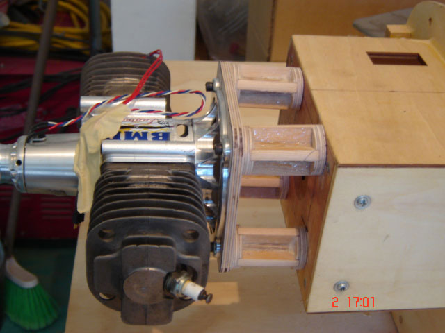

Old 01-12-2007 | 11:56 AM
My Feedback: (7)
Posts: 441
From: Mexico City, MEXICO
Default RE: standoffs
I used to install the ones from Forgues, agree, expensives.
Then I faced my 1st 33% project, I decided to make mine on oak dowel.
Light and cheap.

Old 11-28-2010 | 02:12 PM
Posts: 18,602
From: Valley Springs, CA
All my standoffs come from the same place. The hardwood dowel section at the local hardware store. 3' or 4' lengths that are cut to exactly the desired length every time without having to stack up a bunch of washers or other stuff to get the end result. $2.50 worth of wood dowel makes a lot of standoffs. Then you have the option of adding sides to the wood standoffs to increase rigidity and decrease vibration that cannot be come with commercial aluminum standoffs. They work for any size engine. All that's required is the desire to make them.
If you have a measuring tape and a mitre box you have all that you need to do the job.
