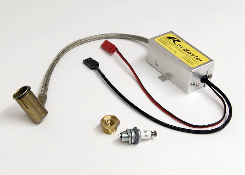

For those of you who may be interested, this is what the "NEW" Brison 2.4 looks like now. The ignition shown is an ignition noise reduction "UPGRADE" @ $45.00 US. Not sure if this "upgrade" is essential or not. The engine really has a much cleaner look.

Don, Is there a clamp to help secure the spark plug cap?

ORIGINAL: Bass1
I do not have the engine YET. These pictures were e - mailed to me by Cimmaster in Ontario, Canada who are now manufacturing the Brison & Revolution engines ( that's another story we all know about ). But to answer your question it looks like there is a "spring ring" around the metal boot in order to hold it on. I personally would use a gear clamp just in case.
This ignition upgrade was suggested by Cimmaster in cases where you may have radio interference with the standard type spark plug lead. I like it because there is no ground wire to hook up. I am considering another 2.4 and that is why I got them to e - mail me some pics. The ones on there web site depict the old style mechanical advance. Is the electronic any better ? Who knows. But apparently this is the only way they come now. With all the "cheaper" competition available now I'm not sure how they will fare. They are $450 ( engine & standard ignition ) + $45 ( optional shielded ignition ) + $96 ( Bisson pitts ) = $591.00 + shipping. Pretty expensive for a 40 cc engine [X(]
Are they that much better than the competition ? That's a personal preference I guess.

The new type ignition will not provide any better noise prevention than a properly installed odler style. Some may have noticed that CH came out with the shielded plug wire, the same as this newer unit, quite some time back, still using the standard sized spark plugs. However, the new ignition does provide a means for the user to run a smaller CM-6 plug, which is often a bit more difficult for some to obtain. Makes for an easier "in cowl" installation with the shorter plug. Those that have the older CH ignitions can do the same thing by contacting CH to obtain the plug adapter and sending in their old ignition for a plug wire/cap conversion. You probably won't need the external shielding with the CH conversion, though.
I have to admit the the housing for the Hall sensor and the rotated carb body looks pretty good. Other than that, it appears to be the same engine it was before.
