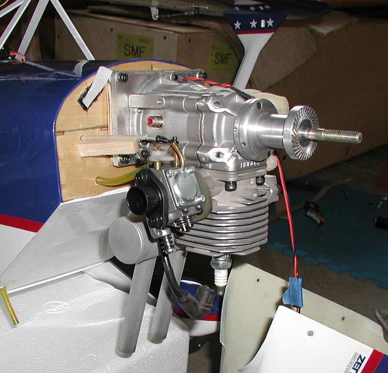

But... you'll only need stand-offs if you need to move the engine forward for cowl clearance. I have mounted a few G26's with only spacers to give the correct thrust angle. The attached picture shows this better.

Birddog-RCU,
You are correct. I have a Brillelli 26cc mounted straight to the engine box on a CMP Giles 202. If it works out to be the proper distance to the back plate no stand-offs are required. There's always more than one way to skin a cat .

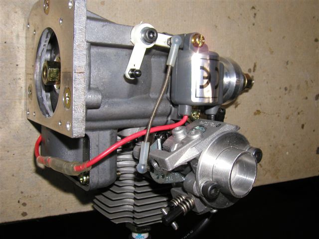

8/32 or 10/32 hex head bolts thru the engine into blind nuts in the firewall.
