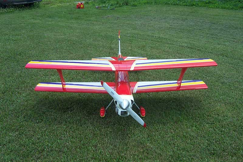

Hi..
I have DA-50 on my CH double vision the prop is 22x10 can you help my pleas on how to tune it
Thank's[img][/img]

I normally set the high speed needle first for maxium rpm then I lean then low speed needle for the best transition.

you meen yo leen the high needel after you len the low needel ??
but how you knoe that this is the max power??

When the high needle is to lean the rpm will drop off so richen until you have reached the max rpm. I then work on the low speed needle either leaning or richen until you get a smooth transition from idle to full throttle.
From factory setting start off leaning the high speed needle.......normally you will also lean the low end for best transition and idle.

I have a feeling you'll end up changing that prop to a 22-8 or 23-8. The plane may be a little fast with the 10 pitch. The DV will effectively fly at some pretty low airspeeds with the right prop.

I'm running a 22X8 on a DA50 on my DV and it's plenty. It hovers fine with it.
