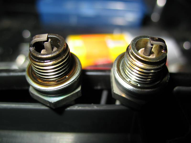

I recently bought a used BME 110 from a member on RCU, I finally flew it this week and noted that the left cylinder is running way hotter than the right. The right is about 205-215 degrees and the left is about 280. I have the cowl baffled and opened the intake holes about 1/2 inch on the cowl. About 1/2 of the bottom of the cowl is cut-out.
This morning I went out again to try some stuff again. I turned the high-end needle out 2 turns so the engine is running rich. The left cylinder is still about 270 degrees and the right was about 195 degrees after 8 minute flight.
While I was out at the field this morning I also ran the engine up on the ground with no cowl installed and took temperature readings afterward. The right was 220 degrees and the left was 255 degrees, so even on the ground the left runs hotter.
Enclosed are pictures of cowl baffle and spark plugs after this mornings flight.

Here is the spark plugs.
Any ideas from the engine experts out there. thanks

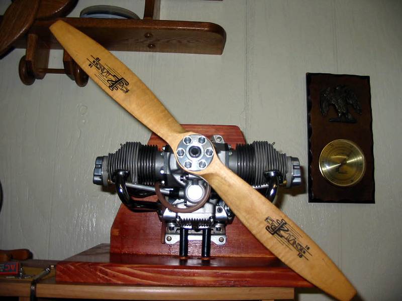

Posts: 12,957
From: Hesperia Michigan, MI
Default RE: BME 110 left cylinder hot
I am lucky I guess...my Kavan twin cylinder temps run within 2-3 degrees of each other. It is a 4 cycle though.

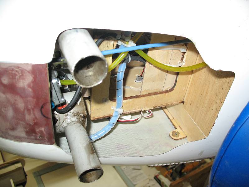

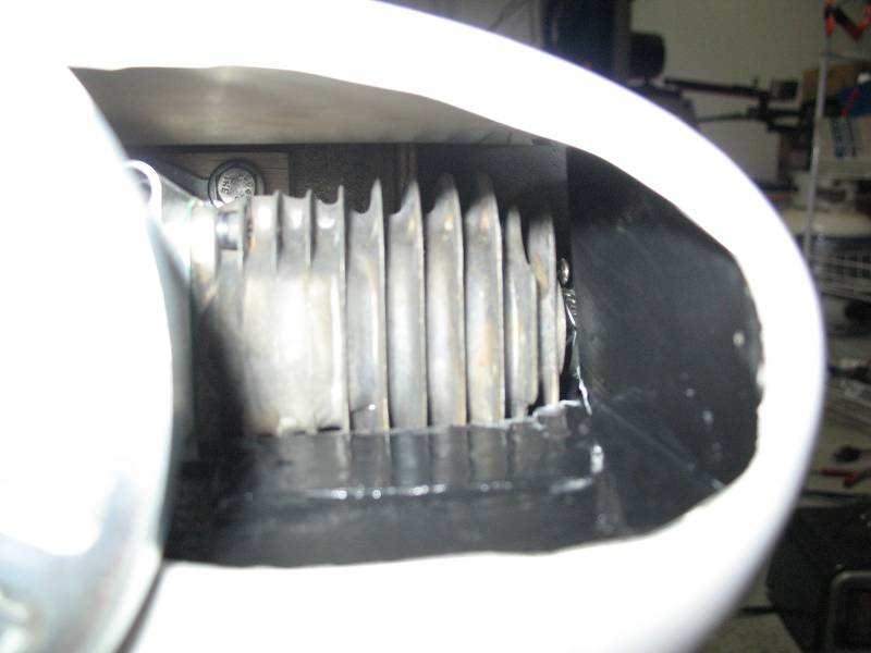

I also thought about that but, it only takes a few seconds on the ground to get the temperature up that high and when in the air it was flying for 8 minutes, anyway in those few seconds on the ground the difference was still 35 degrees and just like in the air it was the left side that was hotter. I will post a few more pictures when I have more time.
Approximately half of the lower cowl is removed, I originally had a 3W-80 single cylinder engine in this cowl, so it is open pretty much from the back of the carburetor to the firewall.
Is it possible that I am getting some air sucked in from the bottom of the cowl and because of that I am not getting proper airflow from inlet to outlet?

I would also suggest putting a angled lip (about 1/4 inch or so) on the exit to help create a low pressure zone and pull more air thru, but I would have to look at the pictures. If you have too much removed the air might be hitting the fire wall and actually backing up the air.

That is definitely possible. Here are a couple more pictures.

If you could close the front bottom portion a little more to just behind the mufflers and make a low pressure lip, I think that would do it.
You could also deflect the air flow down the back side of the cylinders, I have found that really helps in temps.
I don't think the size of the exit area is as important as good flow through the fins of the cylinder and out.

RTK: I like that idea and think that is the first thing to try. I'll use this beatup old cowl as the test-bed and if it cools the engine I will incorporate that into the new cowl as well as getting the upper baffle closer to the engine. Also I will play with the needles a bit more.

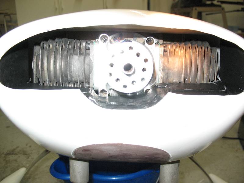

For anyone who followed this thread, this is what I did to close in the cowl, after switching to the BME 110. Hopefully the airflow will be good now and the engine will run in good temperature range. If this works I have a brand new cowl sitting here to install in place of this beat up and cut-up cowl.
BTW I ordered the new cowl from Wildhare last Wednesday after getting home from work in the afternoon, when I came home Thursday afternoon from work the cowl was already at my door. Now that's customer service.

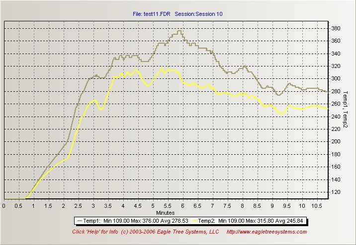

ORIGINAL: rcairflr
rcairflr
Your baffling system should be OK. In my experience with BME110 and what I have seen in this forum from other twins, one cylinder tends to run hotter than the other one, here you are the latest cylinder readings I recorded yesterday from my eagle tree data logger, don’t worry too much about the temperature differences unless is way too large. (There was a hovering being executed during this session):
BTW I installed a baffle system on my BME110 as well, I think is a good idea to obtain optimal performnce on twin egines.

Albatross--Where was your sensor placed on the cylinder?? Front or rear side??
Old 05-20-2007 | 05:44 PM
My Feedback: (7)
Posts: 441
From: Mexico City, MEXICO
Thanks to ask.
The thermocouples are not longer facing the open front of the cowl openings.
I moved 90 degree off that position, the thermocouple is now orientated toward the bottom, of the cowl.
