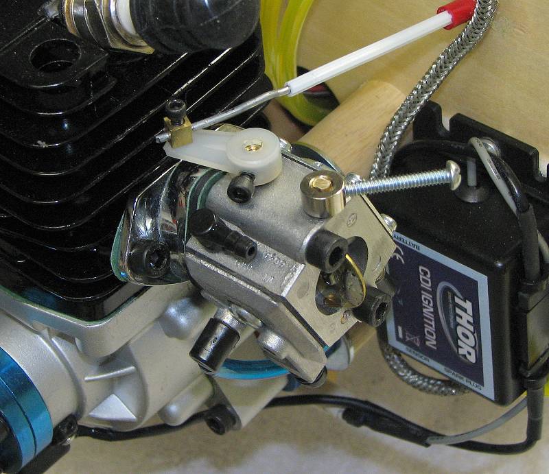

Posts: 680
From: OR
Default RE: Choke really needed?
ORIGINAL: killerG
I just got my first gas motor, a Brillelli 46. The choke arm is going to hit the cowl and I don't really want to cut a hole in the cowl. I am not using a choke servo. so can I remove the choke?
I had the same situation so I simply cut off the lever arm and JB Welded the head of a 8-32 or 10-32 socket head cap-screw to the choke axle (whatever you want to call it). Now I operate the choke with a ball end hex-driver through a small hole in the cowl.
[8D][8D]........RJ

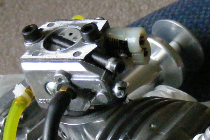

Meant to attach this photo but didn't suceed on the first try

Like I said I am going to keep the choke and do what RJconect did. Good idea!

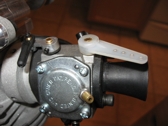

Here's how I do it.
Throttle arm is an old nose wheel steering arm.
Choke has a wheel collar and a 6-32 bolt that could be made shorter.
10 minutes, a few spare parts and VOILA, Instant choke and throttle linkage

Well I did mine like RJConnet and it worked like a charm. Now now hole in cowl and I retained the choke!
