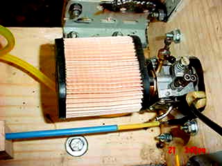

I have one of the aluminum venturis as shown on the new ZDZ40 Rear Exhaust model -
Engine should be here next week - I am going to do a complete shakedown -on th bench and I will also try the nice filter you show - Thanks for the tip!
Once I tried the rear carb setup -I hate the though of anything else -but I had not found a filter I wanted.
Posts: 90
From: Estevan, SK, CANADA
I always wanted some way to filter the air, but like you, i couldn't find anything decent. A buddy made the straight stack for me. The filter slides right over it. It is not a real tight fit but it is snug. I still may put a rubber band around it and secure it to the choke shaft. It only weighs a couple of oz's and is of the paper design. I paid $6.95 canadian for it.(about $4.00us) VERY cheap insurance.
I agree with you on the rear carb design. It is the only way to go. I've had the cowl off of my cap after a couple of weeks of flying and there is all sorts of junk lying around in there. I just didn't want to have my engine digest any more than necessary.
ttyl
ttyl

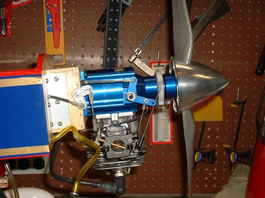

Thanks for your info but what I am concerned about is the additional hassles of setting one up. DH I hope you really didn't intend this to be directed at me. " For a new modeler with little or no woodworking skills yet- I can see where it may look intimidating."
My concern has to do with the potential need to move the firewall or fuel proof the inside of the fuse, create a hatch where there is none, or making a large vent in the fuselage etc. As an example, here is a picture of my edge, and as you can see the carb on a ZDZ would end up half way in and half way out of firewall making adjustments difficult at best. On top of that I would need to make a hatch where there is none to get to the needles even if the firewall was not in the way. How about venting of the fuselage. I assume that you will need a vent at least twice the size as the carburetors venturi. I'm really just asking questions about what some of the potential problems might and what you have done to address them.
I was not poking fun at anyone-simply noting that some have just entered the hobby-Skills take time to learn.
The setup for a rear intake is not hard - If you leave the entire space at the top of the firewall open -there is no restriction in accessing the carb!
Look at my web site -I did a Edge when the H9 ARF first came out. Look in the Workshop hanger.
My website is listed in my profile in RCUniverse
