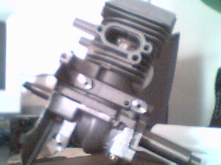

Ok here we go! My big block Tecumseh (138cc) arrived today. Got very disappointed at the initial weight of 24.2lbs! After breaking it down I'm rather happy with a weight of 9lbs!! I still have to remove more metal and the back chunk of shaft, this should be good for another 1 to 1.5lbs. Hopefully this will put me at my target weight of 8lbs bare, not to bad for a brand new engine of 138cc and a price of $100 shipped. Anybody up for the challenge to make a prop hub?

Old 03-29-2003 | 07:14 PM
  #55
Posts: 1,599
From: Loxahatchee, FL
Default Addicted to conversions?
Another shot. What do you think RCIGN1?
Nothing like a good challenge...Send it

Let me get the rest of the metal off and I'll call you. Of course a muffler will be needed as well. Any ideas for that?

Abell Mfg..You can send him the bolt pattern and he will make a welded aluminum muffler...His G23 muffler works very well on the G26, and is only 200 rpm down from no muffler at all.....
