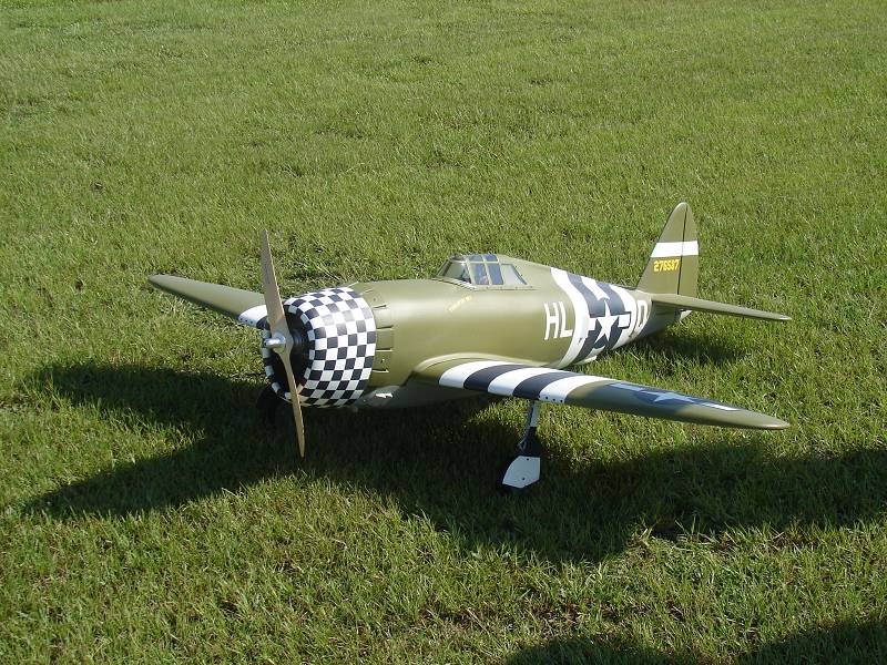

Got some questions for the experienced G62 users. I have a G62 I'm using in a Topflight P-47. It is equiped with the stock magneto and spring starter. It starts easy, idles fine and transition is excellent. I'm using a slimline pitts style muffler. With a master airscrew scimitar 22/10 I get 6400 RPM. The P-47 flies Ok with this set up. It's weight is 26 pounds dry. Tank is 24 0z. It is no rocketship however and it slows down fairly quickly when I put it in a steep climb. Any thoughts on this rpm performance and prop?

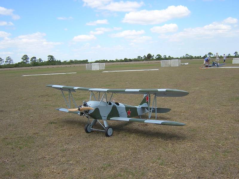

Hi Guys, thanks so much for the great responses. I flew again today and borrowed a friend's 22/10 Mejzlik. Wow, differnt airplane. It did everything better. I was seeing 6700 rpm with the slimline and I think I can go a little more lean after I get a little more time on it. I should have known because I have a 28/10 Mejzlik on a 3W 100 and it really performs well.
I do need the weight of the stock G62 with spring starter. And I have everything as far forward as possible. Right now the Jug's performance
is very nice, and the high speed passes are good......but tell me more about Ralph???
Oh and the comment about the scimitar working well for WWI biplanes is
very accurate. I have a Polikarpov PO-2 (WWI technology used in WWII)
and it flies great. The radial turns the 20/10 about 6900 rpm. The scimitar
is also pretty close in appearance to the full scale original belive it or not.
Thanks again for all the good input. DWR.
